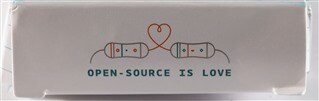

It's not often it happens, but a little while back, I had a package arrive for me thanks to element14, with a little treat for me inside.
Unboxing
As you would have guessed from the title - it was a Genuino 101, one of Arduino/Genuino's latest offerings. It came a little squashed, but otherwise internally unscathed.
