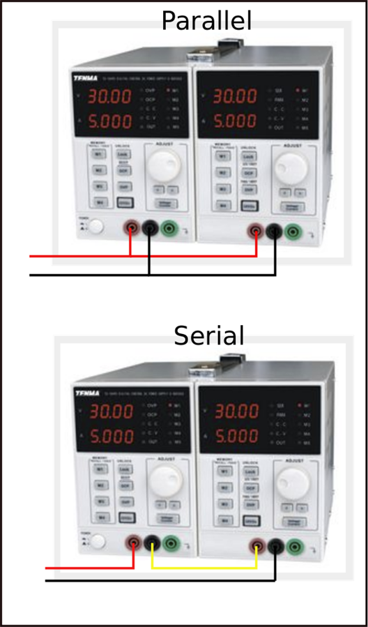

  • colporteur
    0 colporteur over 6 years ago in reply to xueyin.agerris
    If I recall my basic electronics correctly here is a physical hookup for a parallel or serial configuration for dual power supplies. The supplies my provide this capability using a programmable configuration and not require physical jumpers.
    Another consideration is to ensure none of the power supplies have limiting that will result in one supply trying to carry the load. I recall working on a unit that had three supplies feeding a combiner. When one supply got weak the others would still try and carry the load. At some point the other supplies limits would trip because the two were trying to do the work of three.
    I did a search on the power supply reference you provided. This is what was returned for a link.

  • colporteur
    0 colporteur over 6 years ago in reply to michaelkellett
    Your concern has some merit.  The physical configuration wouldn't be my first choice. That being said, it is not a fry the circuit configuration for a dual power supply.
    As I indicated in my post the configurations may be supported programmatic through the powers supply menu.  The description by xueyin.agerris "I would have to connect +ve to +ve and -ve to -ve across the two outputs?" caused me concern. I felt a visual of what would be a correct configuration was better than a verbal.
    To be honest I'm not even sure if the pictorial is the correct model. The link provided in postings didn't source for me. So I used a Google search that returned a picture.

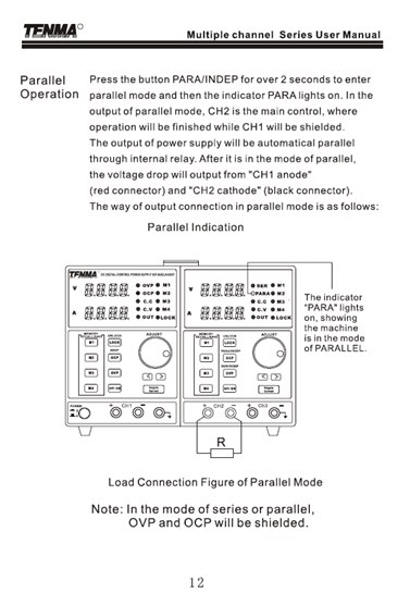

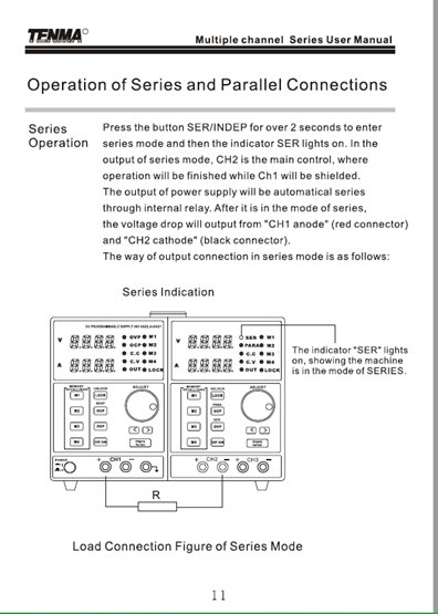

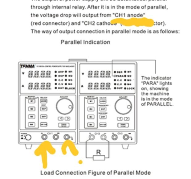

    Thank you for all responses so far! To Michael/Sean: yes I was hesitant to hook up my load because the provided documentation doesn't indicate how this particular model is meant to be used in series/parallel operation.
    I got in contact with technical support at Element 14 and they sent me these photos in an email:
    It's a shame this documentation is so difficult to find. I tried searching the heading in the top right corner, but unfortunately, I still don't know where these pages came from.
    Regardless, it is here if others so seek out this information!

    Thanks for the share. It closes the loop for me.
    The manual picture provided doesn't look like the unit I used in my parallel & serial pictorial. It was in your best interest to find the documentation. Sounds like you got everything you need to continue. If your plan is to draw some amperage don't skimp on cable gauge. Good luck.
