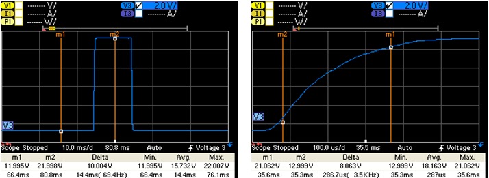

With modern high performance power supplies, transients with rise or fall times as fast as ~ 1ms can be simulated. The below images show a captured 10 V transient pulse on top of a 12 VDC level created with Keysight's N6705B DC Power Analyzer. You can see the measured rise time of the pulse is ~ 300 us.

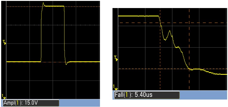

Using the implemented AVR solution I created the below example 15 V 1 ms transient pulse on a 10 VDC level. The first scope shot shows the whole pulse and the second shows the rise time. Both rise and fall times were less than 6 us.

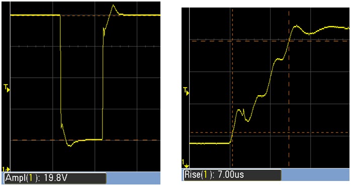

The pulse transient was generated into a 10 Ohm load with a 0.1 uF, 1 uF, and 10 uF capacitors in parallel. This was done to simulate a real world DUT supply input that presents a low impedance to ground for AC signals. Below is an interrupt created with the solution into the same load. The DC level is 25 V. The interrupt pulse is 20 V with a width of 500 us. The resulting fall and rise time of the interrupt is about 7 us.
