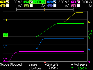

The FPGA circuit under test has four supply inputs. The engineer sets each of the N6705B outputs according to the specified ranges of the FPGA. A test run was done to verify the sequencing and slew rate of the power supply outputs. The result was captured on the N6705B's display and it can be seen in the below figure.

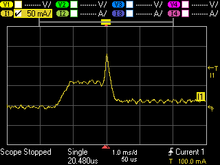

V1, V2, and V3 were all used for powering the FPGA. V4 was used for other components in the circuit. V1 is the FPGA's core supply and that is where we want to measure the in-rush current. Using the timing parameters shown in the above figure, the in-rush current on the core supply was captured and is shown in the figure below.

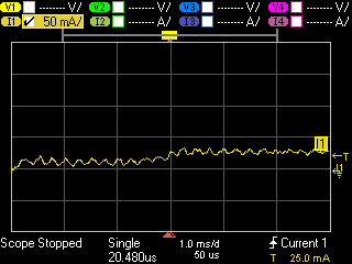

As you can see in the figure the in-rush current consists of two spikes. The first is just over 1 ms with a flat top and the second is a higher current shorter duration spike. After the in-rush current, the low power FPGA's standby static current settles to about 15 mA. The engineer then did a number of tuning iterations of the same test. At each iteration the sequencing or the slew rate time was adjusted with the goal of minimizing the in-rush current. After tuning the engineer was able to get the in-rush current down to essentially zero (see figure below) while still maintaining a proper turn-on of the circuit.
