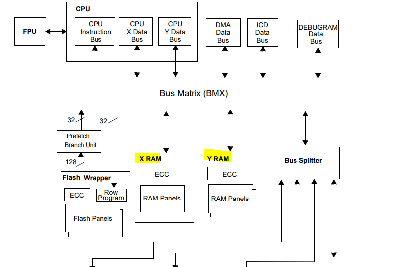

    dsPIC_Microchip over 1 year ago in reply to dougw
    dougw,
    To answer your specific question about data buffering, please reference page 24 of the family datasheet which contains the family block diagram. Depending on the size of the data, The X RAM and Y RAM can be used to route in/out the analog data. Also please refer to page 629 for reference to the DMA.
