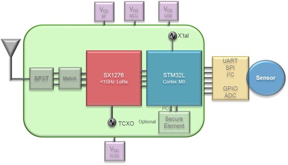

Diagram 1:
Block Diagram of Murata CMWX1ZZABZ-078 Module
  1. The Module, part number
    CMWX1ZZABZ-078, has been designed to support operation in the sub-GHz ISM bands
    with support for operation in 868MHz (EU), 915MHz (USA) and 920 / 925MHz
    (APAC).  The output power of the Module
    will support up to +14dBm in normal operation and includes a PA boost function
    for higher output power, up to +18.5dBm, in regions where this is allowed and
    this is provided at an 50
    W antenna output pin on the Module. STMicroelectronics has
    developed a dedicated Discovery Board based on the Murata Module and the
    I-CUBE-LRWAN software expansion tool is available for various solutions,
    including the Murata Module.  The device
    is in a shielded package 12.5mm x 11.6mm x 1.7max mm and only a minimum number
    of external components are required as part of the reference design.  Radio Certification was done by Murata for
    FCC/IC as Limited Modular Certification, is compliant with EN 300 220 for
    Europe and has LoRa AllianceTM Certification.
