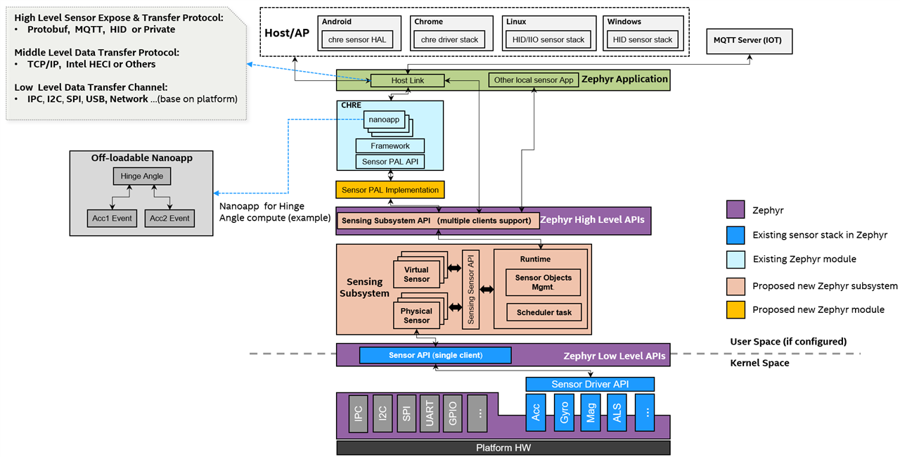

Interfacing with sensors is the fourth, and potentially the most challenging, concept to address. Unlike the ad-hoc methods common in MCU SDKs, Zephyr provides a prescribed sensor framework. This framework outlines requirements like polling and trigger mode, and specifies how sensor data is read using defined functions.
image source: https://docs.zephyrproject.org/latest/services/sensing/index.html

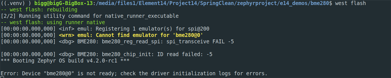

    That sounds interesting. I just gave it a try using the BME280 example (randomly picked one) and I see what you mean about needing an emulated device.
  • neuromodulator
    neuromodulator over 1 year ago in reply to BigG
    Im doing SPI, there is an emulated SPI controller (SPI0 of native_sim DT). As I understand you can connect that emulated controller to an emulated SPI device that would recieve and respond to to SPI operations. Thsts what I'm currently trying to implement.
  • BigG
    BigG over 1 year ago in reply to neuromodulator
    Depends on which peripheral. Based on documentation there's no spi or i2c. But you can use your computer's uart (e.g. TTY driver (UART_NATIVE_TTY)). What looks very interesting is the Ethernet and Bluetooth native sim drivers.
    EDIT. Maybe there is i2c and spi, based on this table: https://docs.zephyrproject.org/latest/boards/native/native_sim/doc/index.html#id1
  • neuromodulator
    Yeah, I'm currently playing with that, I'm currently working on performing some unitary tests with twister compiled in native_sim. What I'm still trying to figure out is how to use simulated peripherals.
  • neuromodulator
    neuromodulator over 1 year ago in reply to embeddedguy
    Yes, twister, and all its testing capabilities.
