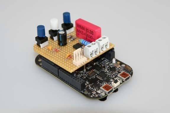

This application note describes the design of a low-cost phase angle motor control drive system based on Freescales’s Kinetis L series microcontroller (MCU) and the MAC4DC snubberless triac. The low-cost single-phase power board is dedicated for universal brushed motors operating from 1000 RPMs to 15,000 RPMs. This application note explains both HW and SW design with an ARM Kinetis L series MCU. Such a low-cost MCU is powerful enough to do the whole job necessary for driving a closed loop phase angle system as well as many others algorithms.
       -Freedom development platform with universal motor drive board extension
The phase angle control technique is used to adjust the voltage applied to the motor. A phase shift of the gate’s pulses allows the effective voltage, seen by the motor, to be varied. All required functions are performed by just one integrated circuit and a small number of external components. This allows a compact printed circuit board (PCB) design and a cost-effective solution.
