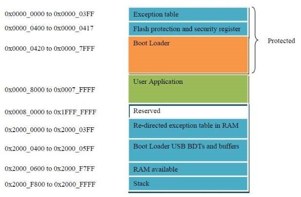

A bootloader is a small application that is used to load new user applications to devices. Therefore, the bootloader needs to be able to run in both, the user application and bootloader mode. As an example:
After reset, the device attempts to run the user application. If the user application is not found or corrupted, the device automatically runs into bootloader mode. In case the application is valid and user wants to run bootloader program, external intervention is
required such as pressing a specific key at reset time to force the device entering to bootloader mode.
