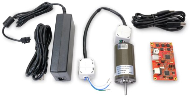

The S12ZVML-MINIKIT evaluation kit is based on the 16-bit S12 MagniVRegistered S12ZVM microcontroller and is engineered for 3-phase BLDC and PMSM sensorless motor control applications, also work for DC applications requiring load switching and load current monitoring. The S12ZVML-MINIKIT uses an S12ZVML MCU —integrating an automotive voltage regulator, a LIN physical interface, and a gate driver unit able to drive up to six external MOSFETs.
The S12ZVML-MINIKIT evaluation kit contains the hardware you need to kick start your Motor Control design:
  • S12ZVML-MINIBRD reference design board
  • 3-phase Linix 45ZWN24-40 40W PM motor
  • 12V/7A Power Supply and cable
  • (Type B, US/Canada st.) USB cable
  • Get started card with support package information
