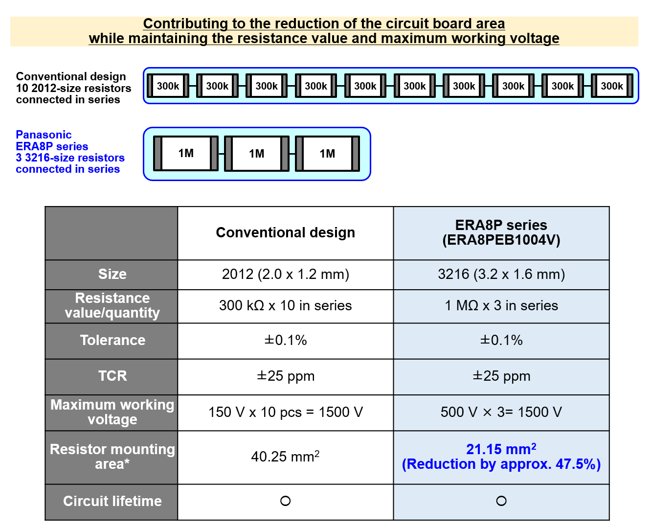

Application 1: Voltage Monitoring in BMS Circuits
Challenge: High-Voltage Monitoring in Compact Spaces
EV battery packs are constructed by connecting multiple modules of small cells to achieve high-voltage output. For instance, one customer utilizes a battery system with a maximum operating voltage of 1500 V. In their conventional BMS voltage monitoring circuit, they employed ten 2012-size (2.0 × 1.2 mm) thin-film resistors, each rated at 150 V and 300 kΩ, connected in series.
Solution: Panasonic ERA8PEB1004V Thin-Film Resistors
To improve space efficiency and reliability, Panasonic proposed replacing the ten resistors with three 3216-size (3.2 × 1.6 mm) thin-film resistors rated at 500 V and 1 MΩ (Model: ERA8PEB1004V). This change reduced the mounting area from 40.25 mm² to 21.15 mm², achieving a 47.5% reduction in board space.
Technical Advantages
  • High Precision: ±0.1% tolerance and ±25 ppm temperature coefficient (TCR)
  • Long-Term Stability: Designed to maintain accuracy over extended periods
  • Stress-Absorbing Design: Proprietary materials and structure reduce solder cracks caused by thermal contraction
  • Superior Reliability: Maintains connection integrity even in high-stress environments
Panasonic’s design addresses a common issue in long-term use—solder cracking due to thermal mismatch between the PCB and mounted resistors. While larger resistors typically experience greater stress, Panasonic’s thin-film resistors outperform competitors in connection reliability, regardless of size or film type.
Comparison with conventional design

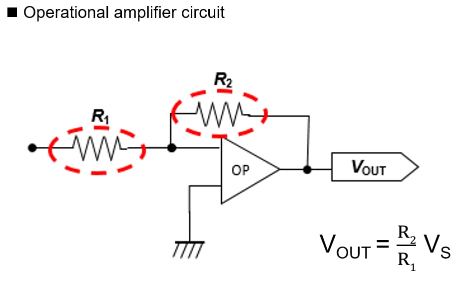

Application 2: Operational Amplifier Circuits in EVs
Challenge: Precision and Miniaturization in Amplification Circuits
Operational amplifiers are widely used in EVs to boost battery voltage to required levels. The amplification factor is determined by the ratio of two resistors (R1 and R2), making precision a critical requirement. Unlike BMS circuits, these resistors do not require high voltage tolerance but must maintain exact resistance values.
Operational amplifier ci
Solution: Panasonic ERA2V Series Thin-Film Resistors
Panasonic’s ERA*V series offers compact, high-precision resistors ideal for amplifier circuits. For example, replacing a 1608-size (1.6 × 0.8 mm) resistor with a 1005-size (1.0 × 0.5 mm) ERA2V series resistor—both rated at 0.1 W and 75 V—results in a 60.3% reduction in mounting area.
