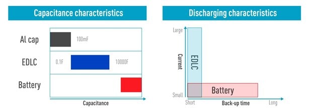

imageElectric double layer capacitors (EDLC) - also known as super-capacitors or ultra-capacitors, have moved increasingly into research and development’s focus recently because of their power delivery performance that perfectly fills the gap between dielectric capacitors and traditional batteries. This attention is predominantly coming from applications in portable electronics devices, electric vehicles, bulk electricity storage at power stations and “load levelling” of renewable sources such as solar energy and wind power. The complex challenges of future decentralized energy supply can only be met on the basis of novel hybrid electrical storage technologies. EDLCs have high power density, faster charge/discharge capability, and wide operating temperature compared to batteries. Since they store energy electrostatically, they can pass through hundreds of thousands of charge-/discharge cycles without losing capacitance. Despite all their advantages, their low voltage level and relatively low capacity stand as a bottleneck for capacitors compared to batteries or redox-flow systems.

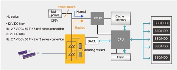

Super-capacitors that are both high capacitance and high output can leverage energy storage solutions that are mountable in a small space. When the super-capacitor is used as an auxiliary power supply during peak output, it can reduce the size of the supply units, add a higher output function, and improve overall performance. Ultra-capacitors are now having both energy and power density high, and so new applications for EDLCs are being developed at an increasing rate. Some possible applications of ultra-capacitors are: Storage/Data backup of cache memory in case of power failure.
Storage/ Data backup of cache memory in case of power failure
Of more interest to the typical design engineer are consumer electronics, computer, and communications applications. Super-capacitors are frequently designed into these products for memory protection. Internal back-up power is another common application. The super-capacitor can be used either as a battery replacement or as a short-term redundant back-up supply. Here, the capacitor can act as a supply for a short period. Batteries are the alternative of the capacitors in these applications. Batteries do not generally have a long product lifetime, and therefore need to be replaced regularly. Today’s consumer appliances are also cheap to the extent that a battery could cost up to 20% of the price of the appliance. EDLCs are therefore a good choice as back-up power supply due to their long lifetime. The fig. below shows the scheme for memory back-up of clock memory via super-capacitor.
