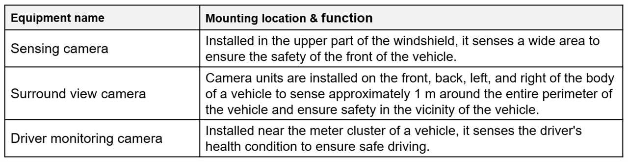

1. What Types of Cameras Are Used in ADAS and AD Systems?
Automotive cameras are essential sensing devices that help vehicles interpret their surroundings. In both Advanced Driver Assistance Systems (ADAS) and Autonomous Driving (AD), cameras work alongside radar, LiDAR, and ultrasonic sensors to build a multi‑directional understanding of the environment.
Modern vehicles typically integrate three primary camera categories:
• Sensing Cameras (Forward‑Facing)
Mounted near the top of the windshield, these cameras monitor a wide forward area to support key safety functions such as lane keeping, lane changing, traffic sign detection, and automatic emergency braking.
• Surround View Cameras
Installed at the front, rear, and both sides of the vehicle body, these cameras capture near‑range images to create a 360° view. They support parking assist and low‑speed maneuvering.
• Driver Monitoring Cameras
Positioned near the instrument cluster, these cameras track the driver’s condition, including eye closure, gaze direction, and signs of drowsiness or inattention.
Each camera type serves different operational goals, yet all contribute to safer, more automated driving experiences.
Mounting location and function of each camera

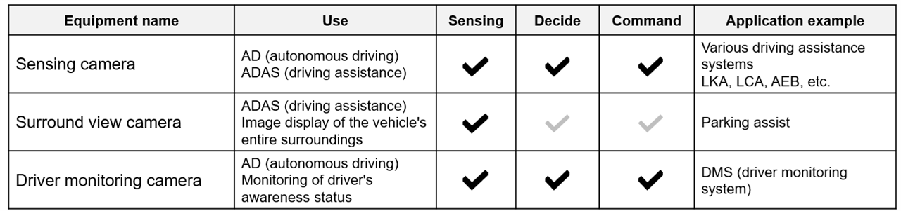

2. Uses and Functions of Each Camera Type
Different ADAS/AD features depend on specific camera modules. Below is an overview of their major applications:
Sensing Cameras
Used for decision‑making and control actions:
  • Lane Keep Assist (LKA)
  • Lane Change Assist (LCA)
  • Autonomous Emergency Braking (AEB)
  • Forward collision avoidance
  • Traffic sign recognition
These cameras play a central role in higher‑level AD systems where precise object detection and classification are essential.
Primarily used for:
  • Parking assistance
  • Close‑range obstacle detection
  • Surround visualization in the cockpit display
These cameras help drivers—and autonomous systems—understand vehicle positioning in tight spaces.
Driver Monitoring Cameras (DMS)
Used for:
  • Assessing the driver’s alertness
  • Detecting fatigue or inattention
  • Monitoring head pose and gaze direction
As global regulations evolve, DMS is becoming mandatory in many markets.
Examples of the function and use of each camera

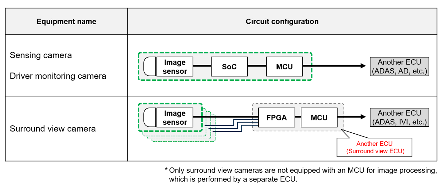

3. Internal Configuration of Automotive Cameras
Although sensing, surround view, and driver monitoring cameras differ in purpose, their internal architectures share common building blocks.
Sensing Cameras & Driver Monitoring Cameras
These modules typically include:
  • Image Sensor – Converts incoming light into electrical signals.
  • SoC (System-on-Chip) – Performs image analysis, object recognition, and high-speed processing.
  • MCU – Issues control commands to external ECUs.
  • Transceiver – Handles data communication with ADAS/AD ECUs.
  • DDR Memory – Provides high‑speed data buffering.
  • Flash Memory – Stores firmware and calibration data.
This type uses multiple image sensors, each positioned around the vehicle.
Captured images are transferred to a Surround View ECU, where an FPGA or high‑performance SoC synthesizes them into a single omnidirectional view.
Because of the volume of image data involved, communication bandwidth and processing speed are especially critical.
Internal configuration of each camera

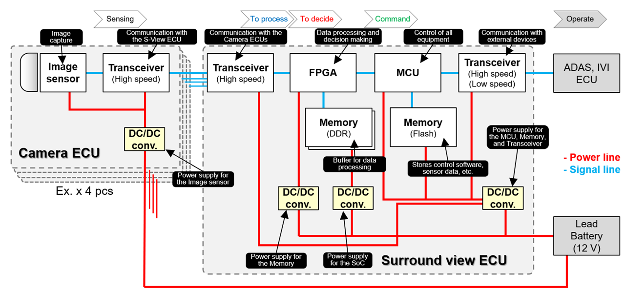

Surround view camera
A camera ECU and surround view ECU are used to make up a surround view camera. Unlike other types of camera modules, multiple camera units are mounted on a vehicle to make up the surround view camera. Therefore, transceiver circuits must communicate larger amounts of data. An FPGA is used to integrate the acquired image data into one, where image processing is performed at high speed.
Other configurations are the same as those of sensing cameras and driver monitoring cameras.
Surround view camera system configuration

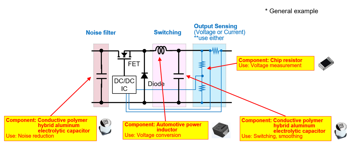

6. Specific Component Examples and Their Applications
Both DC/DC converter circuits and transceiver interfaces rely heavily on high‑performance passive components. Panasonic’s automotive‑grade devices play key roles in achieving reliable and compact designs.
6.1 DC/DC Converter Components
DC/DC converters commonly integrate:
Conductive Polymer Hybrid Aluminum Electrolytic Capacitors
Ideal for:
  • Noise reduction
  • Smoothing output ripple
  • High‑frequency filtering
Key benefits:
  • High capacitance with low ESR
  • Excellent ripple current handling
  • Stable performance across wide frequencies
Automotive Power Inductors
Used for:
  • Efficient voltage conversion
  • High‑current power stages
Key benefits:
  • Metal composite materials for low core loss
  • Excellent current handling
  • Reduced AC resistance at high switching frequencies
High‑Precision Chip Resistors
Used for:
  • Voltage measurement and sensing
  • Feedback control accuracy
Key benefits:
  • Thin‑film structures with low temperature coefficients
  • Accurate resistance values for stable regulation
Components used in a DC/DC converter
