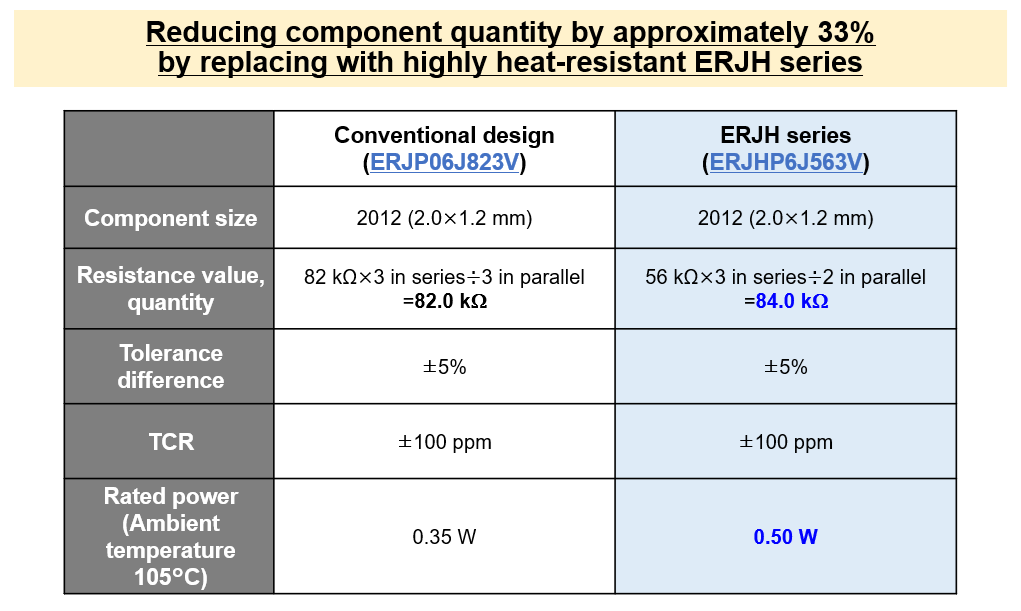

Application Example 1: Voltage-Dividing Circuits in BMS Using ERJH Series
In BMS and inverter rectifier circuits, discharge resistors are essential for safely releasing stored energy from smoothing capacitors during equipment failure. While precision resistance isn’t required, high heat resistance is crucial.
In one case, a customer needed a solution for a voltage-dividing circuit handling 500 V across resistors totaling ~80 kΩ, with 3 W power consumption and ambient temperatures reaching 105°C. Panasonic proposed the ERJH series thick-film resistors:
  • Configuration: 3 × 2012-size (2.0 × 1.2 mm) resistors in series (each 56 kΩ, 0.5 W), with two sets in parallel (~84 kΩ total)
  • Result: 33% reduction in component count compared to previous designs
  • Advantage: Rated for up to 175°C, allowing higher power operation even in high-temperature environments
This solution not only improved thermal performance but also reduced board space and cost.
Comparison with conventional design

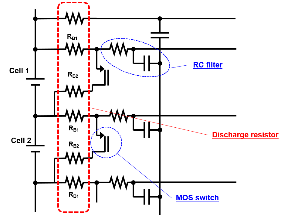

Application Example 2: Cell Balancing Circuits Using ERJB Series
Battery packs consist of multiple cells, each with varying degradation levels. To balance capacity, discharge resistors are used to reduce the charge of healthier cells, aligning them with the most degraded one.
Requirements for these resistors include:
  • Resistance: ~10 Ω (±5%)
  • Power: 1–2 W
  • Tolerance for temperature rise
While multiple thick-film resistors could meet these specs, Panasonic recommended the ERJB series long-side electrode resistors, which offer:
  • Higher power handling due to larger electrode area
  • Reduced risk of cracking during mounting
  • Compact design ideal for limited battery cell space
Example of cell-balanced circuits

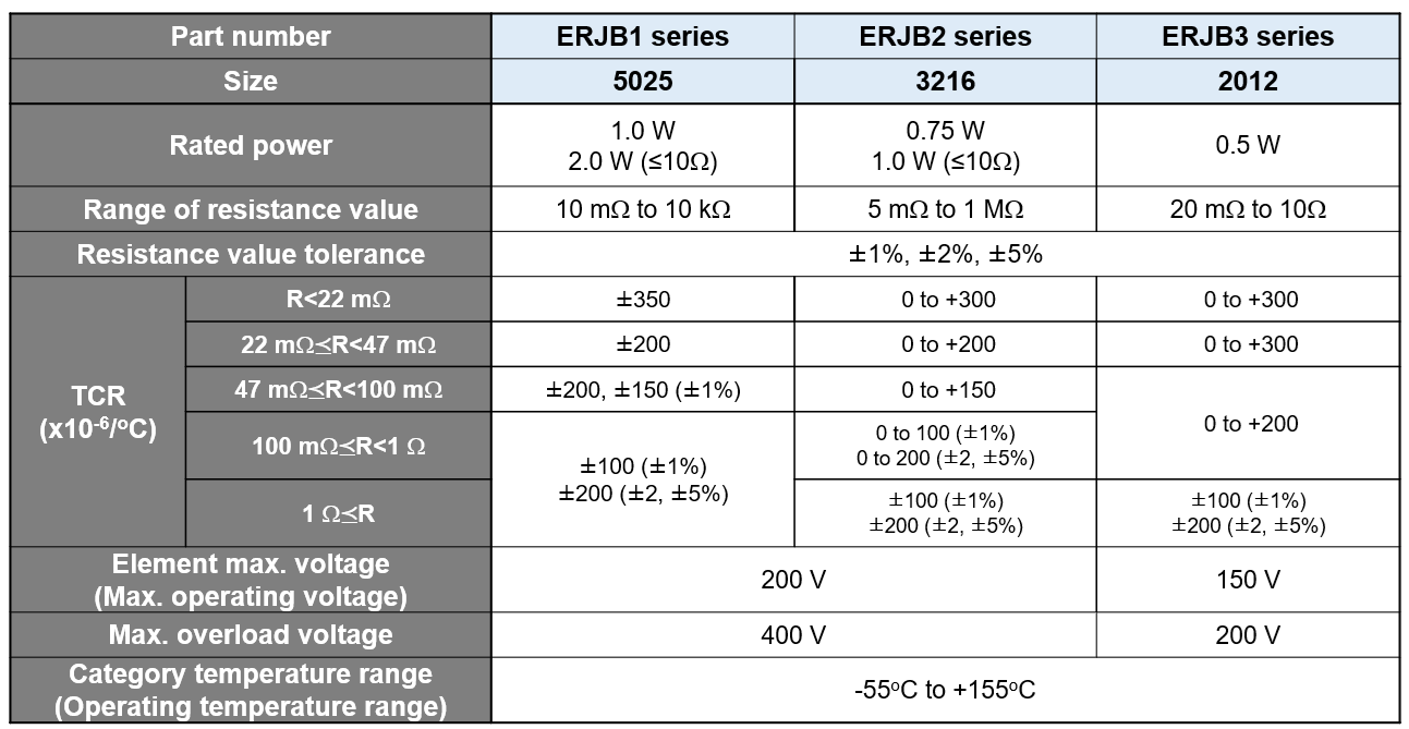

Product Lineup:
  • ERJB3 (2012 size): 0.5 W, 150 V max
  • ERJB2 (3216 size): 0.75 W, 200 V max
  • ERJB1 (5025 size): 1.0 W, 200 V max
    All models operate reliably from −55°C to 155°C.
Lineup of long-side electrode resistors
