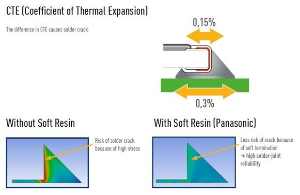

One of the most common reasons of failures or quality problems of conventional chip resistors is solder joint crack. This means that while the resistor is still working without any problems, the solder connecting it to the PCB cracks and therefore, the resistor disconnects from the circuit. This phenomenon often happens because of the difference in the CTE (coefficient of thermal expansion) of the PCB and the resistor. Taking an FR4 PCB as an example, it would have a CTE value of about 15 ppm/K.
A chip resistor’s most prominent piece of construction is the alumina substrate - the ceramic material which dissipates the heat generated by the resistor and transfers it to the PCB. Depending on the ceramic of course, the CTE of the alumina substrate has typically a value of about 7.6 ppm/K.
No matter the resistor technology (thick film, thin film, etc.), the alumina substrate is connected to the outer terminal by the inner electrode. This connection can be made using various technologies; to name a few, sputtering, hard resin, soft resin. Due to the difference between the CTE of the alumina substrate and the PCB, the solder joint and the terminals experience high levels of stress with every temperature cycle. This in time causes the solder joint to form micro cracks which as a result cause the chip resistor to disconnect from the PCB.
Decreasing the risk
Panasonic Industry’s original technology eradicates this problem - or at the very least significantly delays it. As opposed to sputtering and hard resin, Panasonic chip resistors use a soft resin in the connection between the alumina substrate and the outer electrode. This renders the connection between these two just flexible enough so that a significant amount of the stress on the solder joint can be eliminated. Consequently, the solder joint does not crack or cracks much later in its lifetime, decreasing the risk of any failure or quality issues.
