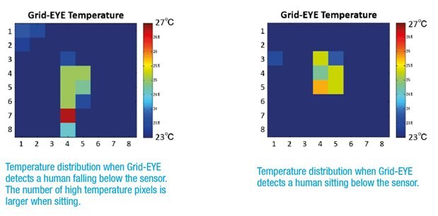

According to the German Federal institute for Population Research (BiB), the number of people who need care could be set to rise by 35% in the next 15 years in Germany alone. In 2013, around 2.6 million people depended on the provision of care, which means that number is predicted to reach around 3.5 million in 2030. The latest statistics on accidents suffered by elderly people at home show that accidents are most likely to be caused by an elderly person falling over in the living room or down the stairs in their own home. In conjunction with the general monitoring of activities and vital signs, being able to reliably identify if someone has suffered a fall is considered to be extremely important as part of efforts to safeguard and promote senior citizens' health and safety. The technology used should be contactless, discreet and as cost-effective as possible. The ability to integrate hardware components into existing living environments must also be an option. What's more, the technology needs to be easy to use as its acceptance amongst users will depend on it. The final requirement is for the broadest range of emergency situations within a living environment to be recognized whilst minimizing false alarms and preventing erroneous emergency calls.
Figure 3
"Professional, electronic assistance systems are definitely the future," says Lothar Feige. The Managing Director of the relatively recently founded company pikkerton says the company is set to shake up the AAL market with an in-house development of its own. AAL stands for "active assisted living", whereby elderly people get to live in their own homes for as long as possible with the help of technology. pikkerton chose to use Grid-EYE when developing its own InstaMon (a light switch design which recognizes and reports falls) because Grid-EYE's sensor data is sufficient for serving subsequent image processing algorithms yet protects the individual's privacy as the sensor does not reproduce images. "We were impressed with Grid-EYE's dimensions and power spectrum," Lothar Feige explains. "And because our sensor needs to fit discreetly into people's living rooms and our aim was to reduce the installation depth to 32 mm, the decision was a no-brainer. Thanks to the dimensions, InstaMon can be built as the form factor of a light switch and can be used in conventional flush-mounted boxes or even surface-mounted frames."
First of all, the infrared array sensor sends the relevant temperature distribution to a micro-controller. This then extracts an extremely wide variety of characteristics from the temperature distribution sent by the sensor. These characteristics are then fed into evaluation algorithms working and learning in parallel. The device is designed as a GSM device (2G) and therefore has a SIM card slot. The integrated dual-band antenna means that the device can be registered on all cellphone networks available across Europe. Depending on the configuration, SMS messages can be sent and even voice calls can be made to any telephone or smartphone.  As a result, direct contact with the person who has fallen down can be made immediately using the integrated hands-free speakerphone.
