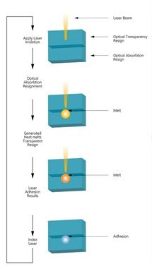

Panasonic’s IP67 tactile switches are manufactured differently. Rather than bond a silicone membrane under the actuator, Panasonic uses a new patented laser method which welds a thin nylon-based film over the actuator. This new method has a clear edge over traditional membrane construction:
                    • Preserves crisp switch feel: The laser welded nylon film has only a negligible affect on actuation force abd click ratio.To take one example, the click ratio changed from 70.15% without the laser welded film to 68.28% with it - for a minor two percent change.
                    • Protects against side loads: Placing the film over the actuator has the side benefit of offering some protection against side loads, which helps prevent damage to the switch.Traditional membrane construction leaves the actuator exposed to damage from side loads.

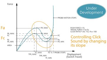

It is essential that the switch operates properly, not only to ensure medication is being dispensed, but that the proper dosage is dispensed on schedule. Panasonic’s Tactile Metal Domes are frequently used to provide the "snap" or tactile feedback and audible sound when a switch is user-actuated and have proven a necessary design. The dome array is part of the switch contact system, which is encased in the switch assembly to provide a solid "snap" or tactile response when the switch is actuated. The design ensures that the moment of tactile response more closely coincides with the moment of contact. The mechanical contact system is extremely reliable in harsh environments and offers a superior tactile response that is consistent from switch to switch. As described in the graph above, all tactile switches have actuation force characteristics that can be expressed as a click ratio that expresses the relationship of the switch’s actuation and contact forces. A higher ratio indicates a "crisper" or "snappier" switch feel. The travel distance, or deflection, of a pressed switch can also contribute to its overall feel. Metal dome or embossed arrays offer easily integrated low-cost contact systems that still allow for custom contact configurations.
