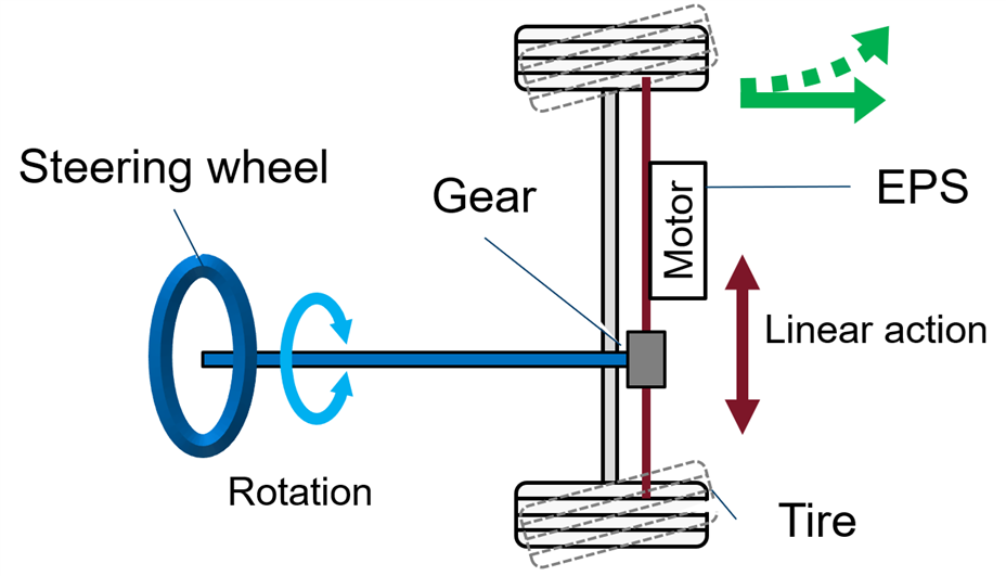

1. Back to Basics: What is Electric Power Steering (EPS)?
At its core, an Electric Power steering (EPS) is a system that uses an electric motor to assist the driver, reducing the effort needed to turn the steering wheel. Unlike traditional hydraulic systems that constantly draw power from the engine, an EPS is far more efficient, only consuming energy when steering assistance is required. This directly contributes to better fuel economy and is a key enabler for electric vehicles (EVs).
Operation of the EPS
(Figure1: Operation of the EPS)

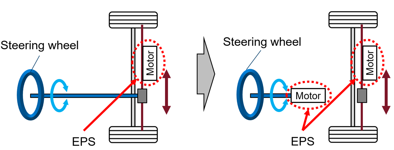

2. The Evolution of Steering: Key Technological Shifts
The EPS is evolving rapidly due to two major trends:
  • Electrification: Modern vehicles rely on battery power. Electrifying components like the steering system simplifies the overall mechanism and improves energy efficiency. For autonomous driving, where the vehicle's computer needs total control, full electrification is essential.
  • By-Wire Connection: The future of steering is "by-wire". This means the mechanical link between the steering wheel and the axle is replaced by an electrical connection. This separation allows for more precise, computer-controlled steering adjustments, a fundamental requirement for autonomous navigation. As the driver's role diminishes at higher autonomy levels, the vehicle assumes primary control, making by-wire systems indispensable.
    Configuration change resulting from by-wire connection
(Figure:2 Configuration change resulting from by-wire connection)

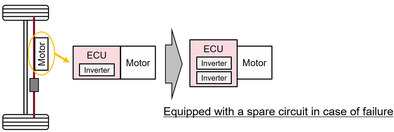

3. The Non-Negotiable: Redundancy for Ultimate Safety
With greater autonomy comes greater responsibility. In a by-wire system, failure is not an option. To ensure maximum safety and reliability, modern EPS designs incorporate a redundant structure. This often means building the motor-driving inverter with a dual-circuit design. If one circuit fails, a backup immediately takes over, ensuring the system remains operational.
However, this raises a new engineering challenge: redundant circuits, along with the need for more powerful motors in advanced systems, increase power consumption. This dilemma forces engineers to seek out electronic components that deliver on four key properties: low loss, high heat resistance, high precision, and small size.
Configuration changes resulting from the adoption of a redundant structure
(Figure3: Configuration changes resulting from the adoption of a redundant structure)
