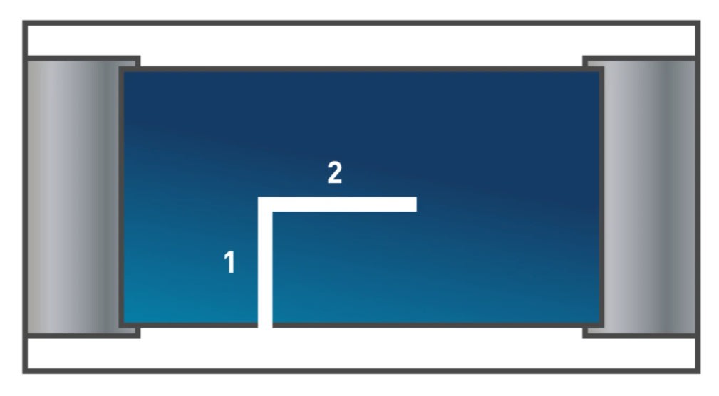

L-pattern:

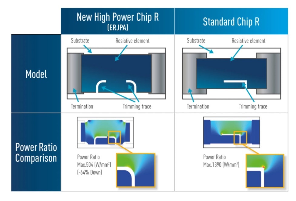

The L-pattern is a fast and well-known trimming pattern. This pattern includes two parts: the first part marked with 1 in image 1 defines the resistance value slightly below the targeted resistance value, while the second part marked with 2 accurately corrects and adjusts the resistance value within the allowed tolerance range. Analyses in the Panasonic Industry technical laboratories illustrate, however, for certain features like pulse-withstanding characteristics, this trimming method is not ideal, because, with the occurrence of pulse, certain areas around the trimming are exposed to higher temperatures and hot spots, see image 3. This is why this laser pattern is mostly used in the more conventional resistors, in which pulse withstanding characteristics are not that essential. The L-pattern is otherwise very fast and easier to apply.
laser trimming - The L pattern
Figure 1. The L pattern

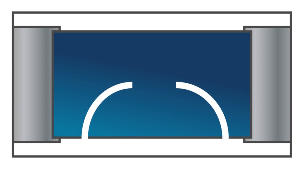

Symmetrical C-pattern:
Panasonic Industry’s solution for producing premium resistors with pulse withstanding capabilities is the symmetrical C pattern. As opposed to the L- pattern, where the pulse load and heat would concentrate on the corner and edge of the pattern and, in this pattern, the trimming shape is changed to an arc, similar to the letter C. The current pathway here is bi-directional, so two symmetrical trimming patterns are used, see image 2. Based on the Panasonic load and heat simulation study, the heat concentration is reduced by 64% using our unique technology. This enables the resistor to have a higher power range and better pulse characteristics.
laser trimming - The symmetrical C pattern
Figure 2. The symmetrical C pattern
However, the C geometry is far more complex to realize with the laser, because it is much slower and has to be monitored meticulously to maintain the desired resistance value. But for applications requiring pulse-resisting chip resistors, the Symmetrical C-pattern would be a perfect solution.
Comparison of hot spot build-up using L pattern and symmetrical C pattern
Figure 3. Comparison of hot spot buildup using L pattern and symmetrical C pattern
