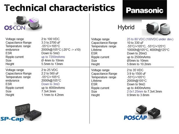

Firstly let me provide you with a breakdown of the Polymer Technologies and their Specification.
What is the Benifits of Polymer Capacitors VS Other Technologies?
  • Reduce number of capacitors using Panasonic Polymer - Please enquire
  • Small Sizes and Height Perfect for Small Devices
  • No Ignition , High Safety and High Reliability
  • Long Life Time at High Temperture - Please refer to table below show Life expectancy estimation
  • No Cracking Of the Polymer device
  • No Voltage DeRating
  • Tantal Replacement - Enquire How Panasonic can help

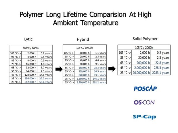

What Is Polymer Lifetime Expectancy ( Long Lifetime Expectancy At High Ambient Temperture)
** Estimation**
