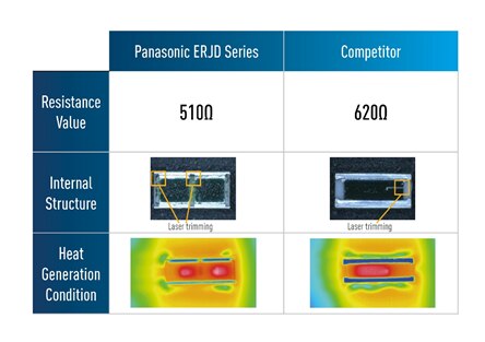

Second: Instead of using one block of resistive element, two or three blocks are used. Each of these smaller elements is trimmed by laser. This supports the heat dissipation throughout the alumina substrate elements and avoids hotspots in one area, as illustrated in image 2.
Image 2: Heat generation in Panasonic wide terminal resistors vs. conventional wide terminal resistors
As a result, the power range can be increased. Depending on the case size of the wide terminal resistor types, they contain two or three resistive elements.
