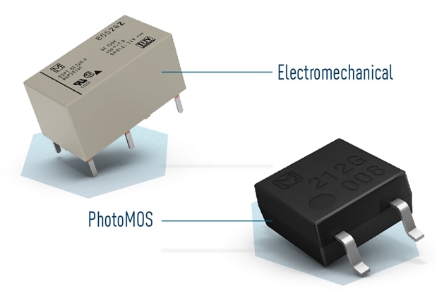

Being based on entirely different switching principles, the direct comparison between semiconductor relays and electromechanical relays turns out to be delicate.
Nevertheless, we attempt to elaborate
the advantages of the respective relay types in the following:
When MOSFET semiconductor relays were introduced to the market about 40 years ago, there was speculation that electromechanics would be replaced by semiconductor technology. However, it has been shown that both technologies have their right to exist, depending on their field of application. Whenever miniaturization, energy-saving aspects, optimized processing, zero-failure-rates or additional functions such as short-circuit protection are required, modern semiconductor technology has an advantage. If the focus is on low costs and a simple and robust design, electromechanical solutions have a clear advantage.
Tasks of electromechanical and semiconductor relays
The galvanic separation of logic or control circuits and load circuits is the task of a relay. Furthermore, it links different signal levels at different potentials without interference. Important for this is: to provide a low power consumption of the logic circuit and an interference-free switch in the load circuit with a long life and reliability - independent of switching cycles. An essential difference between electromechanical relays and MOSFET semiconductor relays is the way the load is switched at the output. In electromechanical relays, the switching function is performed by movable metallic contacts, which is considered to be an additional galvanic isolation at the output. The coupling between input and output, which is also electrically isolated, is effected by the magnetic field of the coil at the input. The differences to the MOSFET semiconductor relay are described in more detail below.

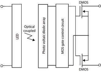

MOSFET relays are a special type of solid state relays. Even at an operating current of only a few milliamperes (min. 0.3 mA), the GaAs light-emitting diode in the input circuit of the MOSFET relay emits light in the infrared range. An optically coupled solar cell array, which is separated from the input circuit by a semi-transparent insulator, converts the light into an electrical voltage. This electrically non-conductive connection enables galvanic isolation between the input and output circuits. The generated photovoltage supplies a trigger stage, which in turn drives the gates of two bidirectionally, antiserially connected DMOSFETs (Double Diffused MOSFETs). These power transistors are located directly in the output circuit of the component. Above a certain threshold value of the photovoltage, the integrated trigger circuit reacts and switches the output virtually digitally on and off to enable a defined switching behavior.

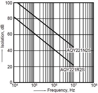

RF characteristics: To achieve sufficient crosstalk attenuation at high frequencies, relays must have low capacitance at the open contact. For electromechanical signal relays, the values are usually about 1 pF. This results in excellent RF properties. Even at a frequency of 100 MHz, the crosstalk attenuation is still 40 dB. Special high-frequency relays, such as the RJ relay, are even designed for frequencies up to 8 GHz. MOSFET relays can now achieve almost as good RF characteristics as electromechanical relays. The output capacitance of MOSFET relays is also 1 pF, depending on the type, so that MOSFET relays can also be used for frequencies in the MHz range. For applications in the GHz range, however, pin diodes or special RF relays must still be used.

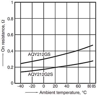

Contact resistance: An advantage of MOSFET relays is that the contact resistance is load-independent and remains constant over its service life. However, the value of the contact resistance is higher than with electromechanical relays and can be several ohms, depending on the switching voltage. It is also strongly dependent on the ambient temperature. In the best case, the value for switching voltages up to 30 V is about 30 mΩ, depending on the type. The contact resistance of electromechanical Relays, on the other hand, always move in the mΩ range and can change significantly over the life of the component. Especially on the contacts of open relays, thin oxide layers can form during long storage periods, which increase the contact resistance. As a rule, a few switching cycles under load destroy these layers, and the contact resistance drops back to the data sheet value.
