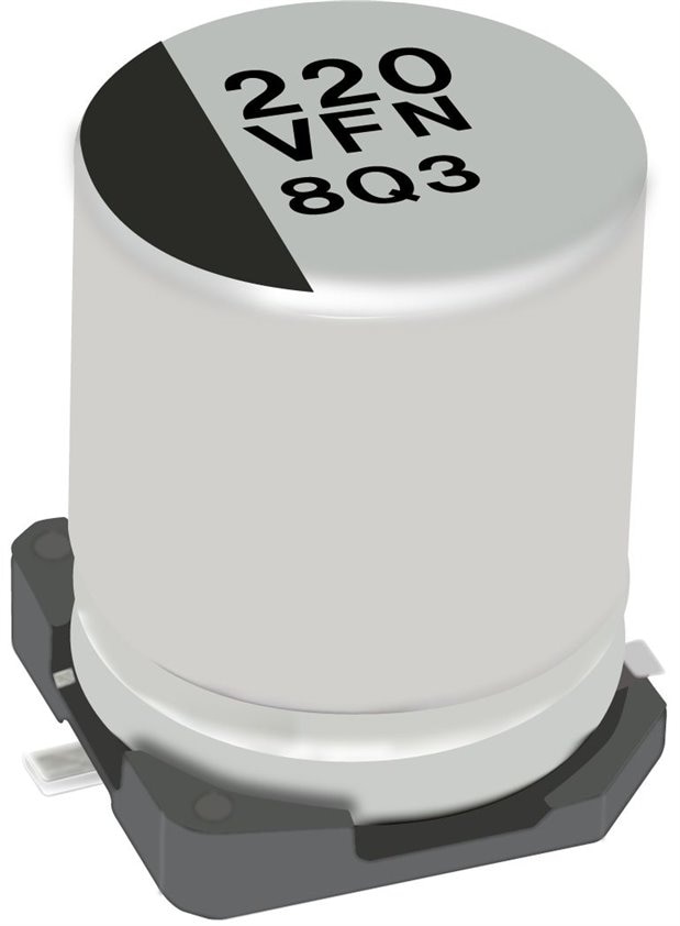

Whether in automotive motor or control systems, industrial power supply solutions or countless other applications: Performant technology coming in slim and miniaturized product designs seems to be more state-of-the-art than ever before.
For meeting those specific requirements, Panasonic Industry Europe just launched the FN series, a low ESR Aluminum Electrolytic capacitors Surface Mount Type. Thus, it’s the latest member of the already successfully established product family offering large capacitance.
Available with a wide voltage range of  6.3 VDC to 100 VDC, the FN series offers re-markable capacitance values (10µF up to 1,800µF), which are up to 50% higher com-pared to other low ESR lytic capacitors on market.
“With 2,000 hours lifetime at a rated temperature range from -55°C to +105°C and low ESR feature, the FN series is the ideal solution for a vast number of contemporary appli-cation designs”, says Yusuke Nagata, Team Leader of Capacitors in Product Marketing department at Panasonic Industry.
The compact design contributes to space saving on the PCB . The low ESR charac-teristics render the latest capacitor series suitable for a wide range of industrial applica-tions in the field of automation and measurement, for automotive components and charg-ing infrastructure and – last but not least – for modern and slim-designed smart home infotainment and control assets.
Vibration-proof variants of the FN series can also be supplied for a size a of Φ6.3 to Φ10. With a vibration resistance of 30G, a smooth board design in demanding automo-tive applications or harsh industrial environment can be guaranteed.
All part numbers are RoHS and AEC-Q200 compliant.
Specs
Temperature range: -55 ~ 105℃
Rated voltage range: 6.3 ~ 100V
Capacitance range: 10 ~ 1,800µF
Size Φ4×5.8L ~ Φ10×10.2L // Vibration-proof: Φ6.3×5.8L ~ Φ10×10.2L
Endurance: 105℃ 2,000h
AEC-Q200 AEC-Q200 compliant
