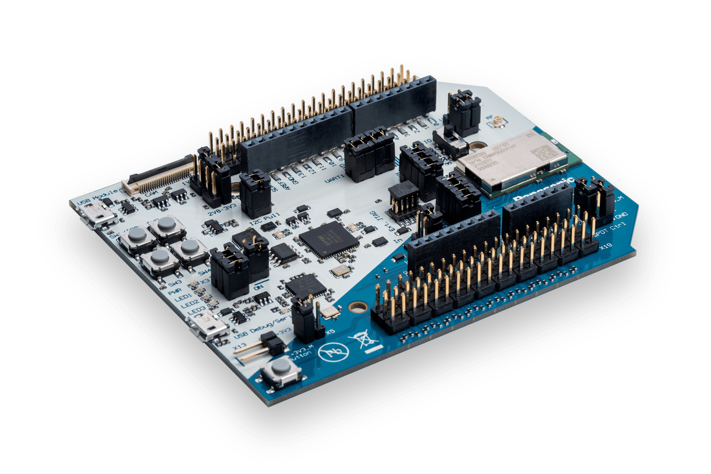

Figure 1. The Panasonic Industry PAN9520 is a 2.4 GHz 802.11 b/g/n embedded Wi‑Fi module based on Espressif ESP32-S2 that includes the powerful XtensaRegistered 32-bit LX7 CPU.

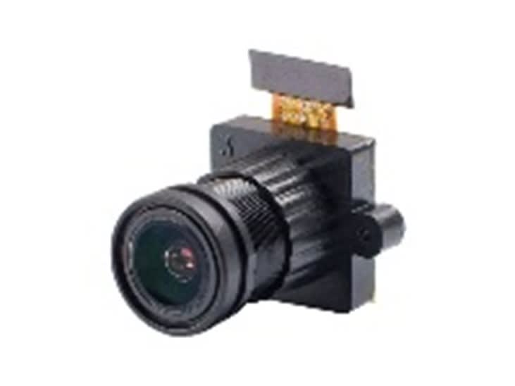

OV2640 Camera Module
Figure 2. OV2640 Camera Module with flexible PCB connector (like this one)

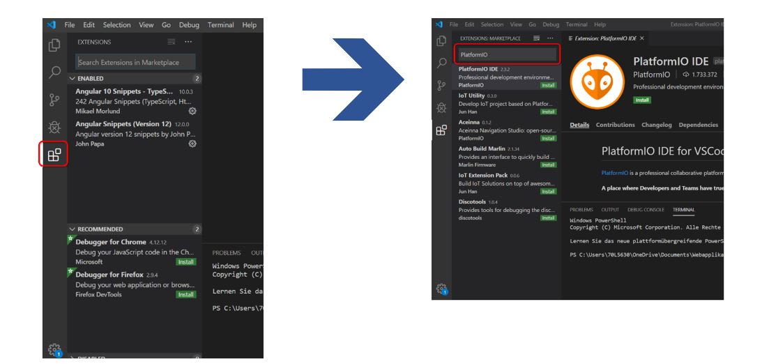

1. Install Visual Studio Code (here)
2. Install PlatformIO Extension over the VS-Code extension menu and wait for the installation to finish, this might take a while.
PlatformIO Extension over the VS-Code extension menu3. Restart Visual Studio Code and clone the project either by typing in the Terminal:

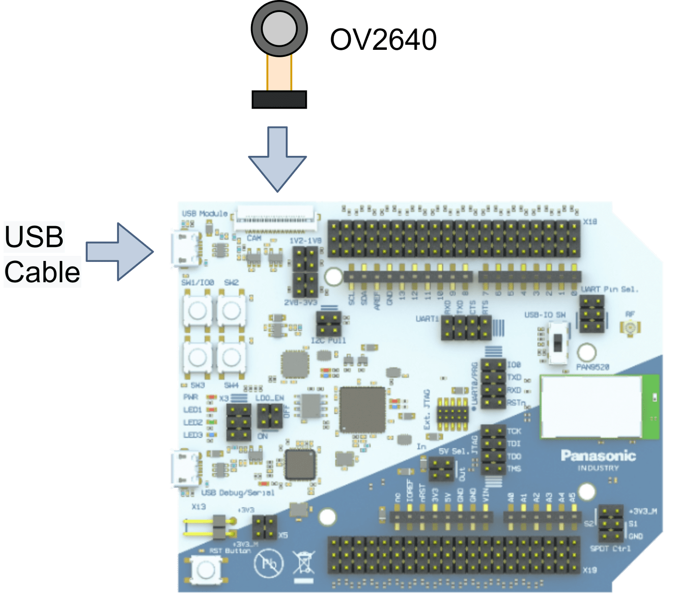

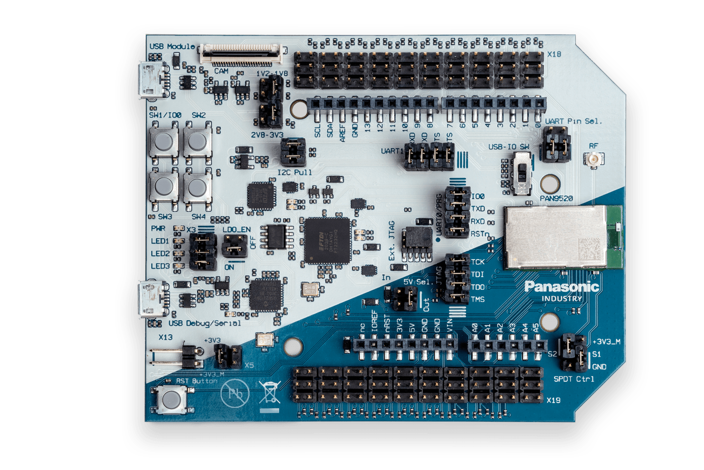

The PAN9520 ETU contains a 24-pin FPC connector for operating a camera module via an 8-bit parallel camera interface and SCCB (Serial Camera Control Bus). Connect the camera like shown in the picture. Please make sure that the lens is turned towards you so that the pinning is the right way round. As soon as the camera and Evaluation Board are connected, plug in a micro USB cable in the “USB Module” Interface.

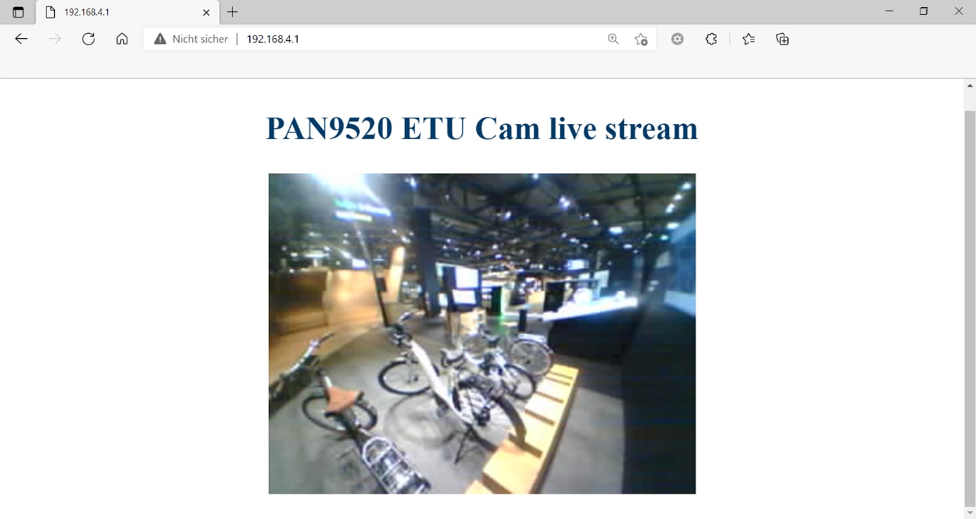

    1. A Wi-Fi Access Point will occur with the SSID you named above
    2. Connect to that AP with the password you set
    3. After the connection has been established open a browser and type 192.168.4.1 into the URL field
    4. Enjoy the livestream!Live streaming from the PAN9520
