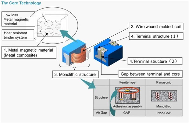

Given the design trends for downsizing/miniaturization, it appears clear that demand will grow rapidly for a new generation of choke coils that can deliver excellent performance characteristics in a smaller footprint. But how can you find a way to solve the problem as mentioned before and build the high performance yet compact inductors e.g automotive applications need? To meet the demands of high performance and yet downsizing, engineers at Panasonic  developed for their Power Choke Coil Series (ETQP-Series) a metal composite powder magnetics choke coil technology that is based on an original Metal Array powder material.
The ETQP-Series  provides following key advantages:
  • Controlling the particle size of the metal powder material leads to high magnetic flux, high permeability and therefore to better DC or AC bias.
  • Thermal aging is prevented and high temperatures up to 150°C can be withstood.
  • Due to its monolithic structure and by reducing the magnetic flow pass way, better electrical characteristics than ferrite can be fulfilled.  Thereby a reduction in case size between 30-50% can be archived.
Panasonic paid especially attention to design-questions for its ETQP-Series as it is able to withstand continuous vibrations of up to 30G of stress. This was archived by damping terminal structure and leading the inductance wire outside and tightly to the body of the coil. Thereby high solder joint reliability and thermal cycle were archived – for a temperature range between -40° til +150°C and this several thousand cycles.
FIGURE 1

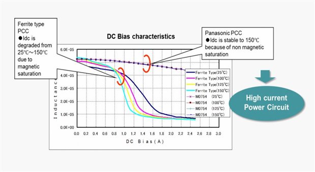

The graphs shown in Figure 2 illustrate the significant performance advantage of the new PCC/ ETQP-Series over a comparable ferrite by comparing inductance values over bias current as well as inductance over temperature.  With the ferrite device inductance drops drastically  once DC bias has reached a certain point. Leveraging the advantages of its new metal magnetic powder, the ETQP exhibits far more stable performance when being exposed to high current along with high temperature stability. Clearly the ETQP device tends to have none  saturation and stable inductance value allowing it to support higher levels of current.
FIGURE 2

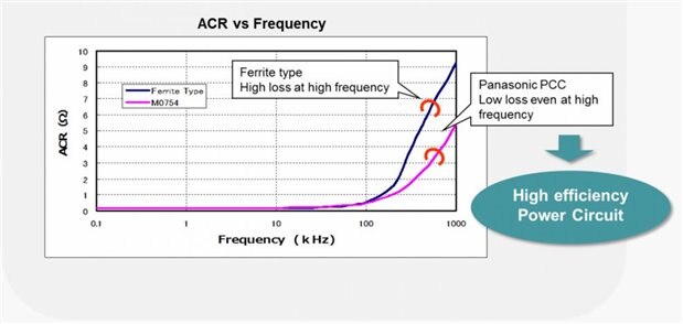

Moreover, the new ETQP-Series demonstrates low power loss at high frequencies than competitive wire wound ferrite products and secures thereby high efficiency.
FIGURE 3
