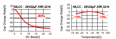

Let's compare how Panasonic capacitors contribute to miniaturization and component reduction with widely used ceramic capacitors in various applications. A characteristic of MLCCs (Multi-Layer Ceramic Capacitors) is the significant reduction in capacitance due to DC bias, as well as the decline in capacitance at high and low temperatures.
MLCC DC bias characteristics, temperature characteristics
(Figure 2: MLCC DC bias characteristics, temperature characteristics)

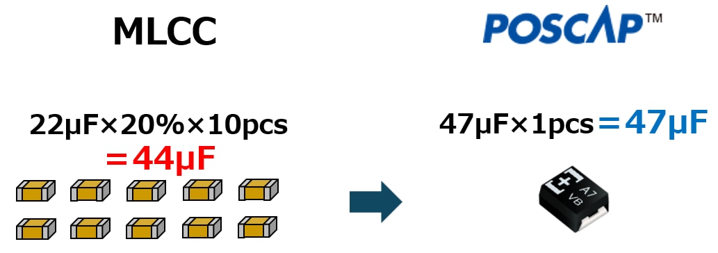

In this example, capacitance decreases by 80% when a 15V DC voltage is applied. Additionally, high and low temperatures cause a decrease of about 10%. For instance, if 47µF of capacitance is required with a 15V DC voltage, considering the reduction, the capacitance must be based on 20% of the nominal capacitance value. In the case of a 22µF MLCC, the calculation would be as follows: 22µF × 20% = 4.4µF
47µF ÷ 4.4µF ≈ 10.7 units
In this example, to secure the required capacitance of 47µF for the circuit, more than 220µF of nominal capacitance and over 10 units of 22µF MLCC are necessary. While it is possible to reduce the number of units by selecting MLCCs with larger capacitance, the typical approach is to use multiple low-cost small-capacity MLCCs, as larger-capacitance MLCCs are limited in availability.
Conversely, conductive polymer capacitors do not exhibit significant reductions in capacitance due to DC bias or temperature changes. Therefore, in this example, 10 units of 22µF MLCC can be replaced with a single 47µF conductive polymer capacitor, reducing the number of components and potentially decreasing total costs, including implementation costs, as well as reducing the implementation area.
Example of replacing MLCC with POSCAP
(Figure 3: Example of replacing MLCC with POSCAP)

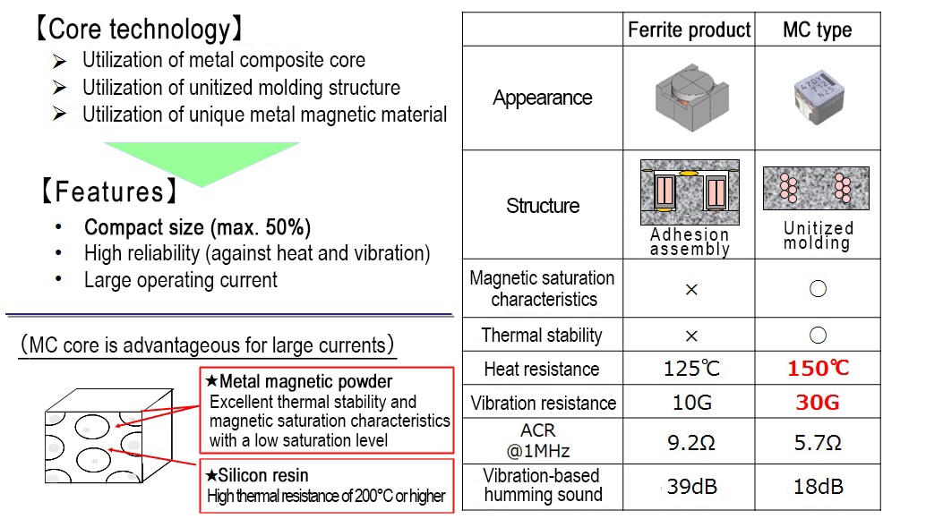

Inductors
Panasonic's Metal Composite (MC) type power inductors feature a metal composite core made from proprietary magnetic materials and an integrated molding structure. They possess superior characteristics within a small body size, offering excellent heat and vibration resistance, ensuring high reliability suitable for robotic applications.
Supporting operation in high-temperature environments with superior magnetic saturation characteristics and thermal stability
The comparison table below highlights the superior magnetic saturation characteristics, thermal stability, heat resistance, vibration resistance, and ACR (AC resistance) of MC types compared to ferrite types.
Comparison of Ferrite Type and Metal Composite Type
(Figure 6: Comparison of Ferrite Type and Metal Composite Type)

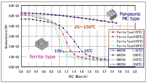

An example of data plotted under different conditions (25°C, 100°C, 125°C, 150°C) for the magnetic saturation characteristics (DC superimposition characteristics) of MC-type and ferrite-type inductors is presented. Magnetic saturation characteristics refer to the phenomenon where inductance sharply decreases at a specific current value when DC is applied, making them one of the key characteristics.
Generally, ferrite types are known for their pronounced saturation characteristics, as indicated by the graph, where inductance sharply decreases with increased DC bias and also varies with temperature. In contrast, Panasonic's MC type does not exhibit a rapid decrease in inductance, indicating saturation, and shows minimal variation with temperature. This is a crucial point for power inductors, which are accompanied by heat generation.
 MC Type vs. Ferrite Type comparison of magnetic saturation characteristics and thermal stability
(Figure 7: MC Type vs. Ferrite Type comparison of magnetic saturation characteristics and thermal ttability)

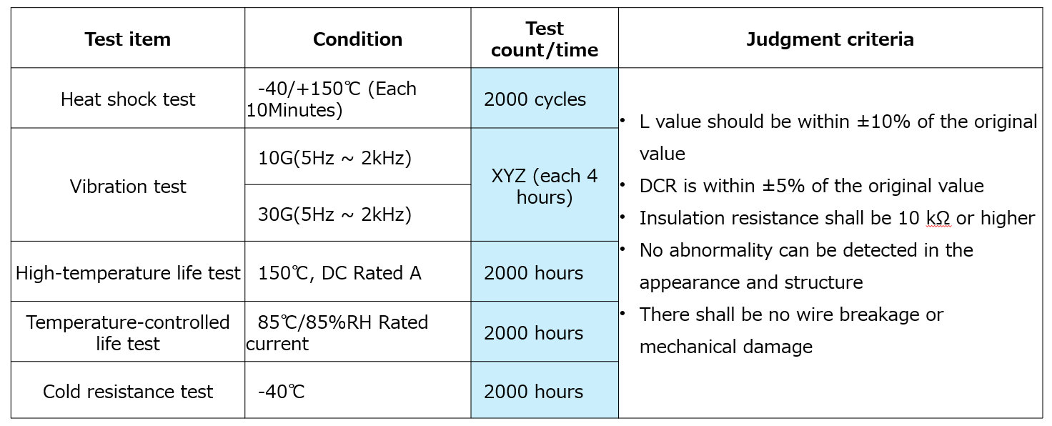

Exhibiting durability in harsh environments with superior heat and vibration resistance
Panasonic's MC type inductors ensure high reliability and are suitable for automotive applications, undergoing rigorous reliability testing. Heat shock: -40°C ⇔ 150°C for 2,000 cycles, and heat resistance at 150°C for 2,000 hours are guaranteed. Below are standard automotive test items and conditions.
Reliability test example (Automotive standard)
(Figure 8: Reliability test example (Automotive standard)

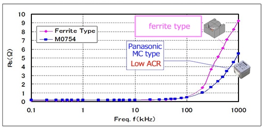

When the frequency of the current flowing through a conductor increases, the skin effect and proximity effect cause the current to concentrate on the surface of the conductor, resulting in lower density in the center and higher density on the surface. Consequently, the resistance component increases at high frequencies, and in inductors, this increased resistance component is referred to as AC resistance (ACR).
The graph below compares the AC resistance (ACR) of MC-type and ferrite-type inductors. As the frequency increases and ACR rises, AC losses increase, leading to higher heat generation. As indicated by the graph, the increase in ACR for the MC type is smaller than that for the ferrite type, indicating lower losses and heat generation even at high frequencies.
Comparison of ACR-Frequency characteristics between ferrite type and metal composite type
(Figure 10: Comparison of ACR-Frequency characteristics between ferrite type and metal composite type)

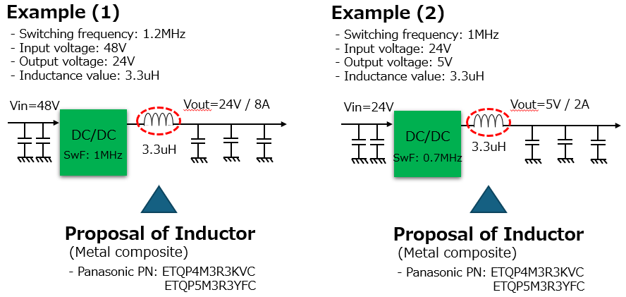

Target circuit points and benefits of Panasonic inductors
The following components are recommended for use in circuits.
(Figure 11: Target circuit points and benefits of Panasonic inductors)

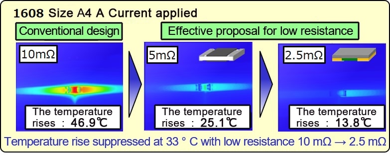

The figure below illustrates the difference in heat generation resulting from different resistance values when a current of 4A is applied. For example, reducing the resistance from 10mΩ to 2.5mΩ can decrease heat generation by approximately 33°C.
Difference in heat generation due to resistance values with 4A current
(Figure 12: Difference in heat generation due to resistance values with 4a current)
Panasonic has developed current detection chip resistors with significantly lower resistance values than conventional products. The use of these resistors reduces heat generation, thereby enhancing energy efficiency. The specific measures taken by Panasonic include:

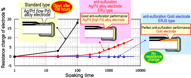

Ensuring durability in harsh environments with anti-sulfur characteristics
Anti-sulfur resistors enhance reliability in environments with high sulfur content. Typical areas with elevated sulfur exposure include locations near volcanoes, hot springs, highways with high vehicle emissions, and industrial sites using cutting oils or rubber-based products. Even in general environments, sulfur can emanate from materials such as lubricants or greases used in cooling fan motors, rubber seals for packing or vibration isolation, and certain mold resins. Silicone-based coating materials can accelerate sulfur-induced corrosion (sulfuration). Thus, in such conditions, the use of chip resistors designed with sulfur resistance is essential.
Panasonic's anti-sulfur chip resistors achieve superior reliability by replacing traditional silver electrode materials with highly sulfur-resistant alternatives. Panasonic offers two resistor series tailored to specific requirements: one focused on absolute performance and another optimized for longevity, balancing performance and cost considerations.
  1. Gold-based electrode pursuing absolute performance
    The ERJS series utilizes gold-based electrodes, recognized for their exceptional stability and superior sulfur resistance.
  2. High palladium electrode enhancing longevity effects
    The ERJU series employs a silver-palladium (AgPd) alloy electrode with high palladium content, significantly improving sulfur resistance by suppressing silver diffusion.
Below are the immersion test results comparing Panasonic’s anti-sulfur chip resistors against general-purpose resistor electrodes when immersed in sulfur-containing oil.
 (Figure 13: Immersion test results comparing anti-sulfur chip resistors and general-purpose resistors in sulfur-containing oil)
In typical resistor electrodes, the low palladium content commonly results in failures (disconnections) after approximately 100 hours of sulfur exposure. In contrast, Panasonic’s ERJU series resistors, featuring high-palladium silver electrodes, exhibit no disconnection even after 3,000 hours, substantially enhancing reliability. A direct correlation exists between palladium content and time-to-disconnection; thus, the ERJU series is designed to withstand exposure exceeding 12,000 hours without failure. The ERJS series, with gold-based electrodes, demonstrates even higher reliability, showing no measurable change in resistance values after 3,000 hours.
