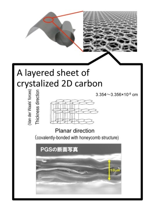

What is PGS?
Pyrolytic Highly Oriented Graphite Sheet is made of graphite with a structure that is close to a single crystal. It is produced from polymeric film using a heat de-composition process. The hexagonal crystal structure of graphite is arranged uniformly in a horizontal 2D structure see figure 1
Fig 1.

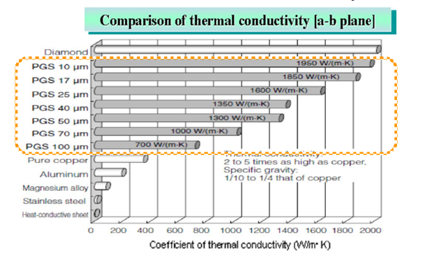

l it is very thin – available in a range of thicknesses from 100µm down to 10µm – and has excellent thermal conductivity from 700 to 1950W/m.K which is two to five times higher than copper and up to seven times better than aluminium (see fig 2)

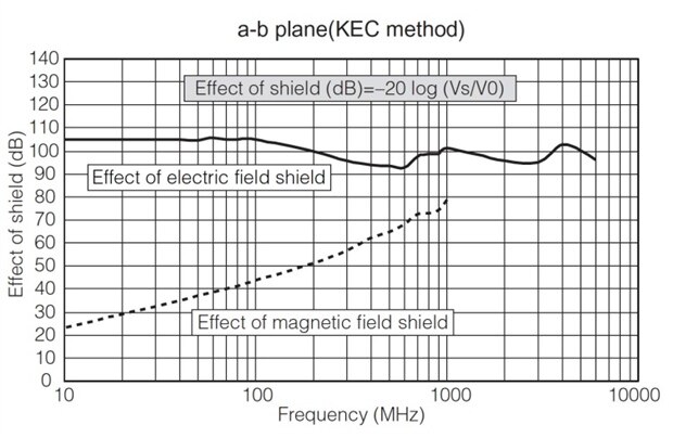

l PGS can provide some shielding to electromagnetic noise, providing a simultaneous EMI and thermal solution (see fig 3).image

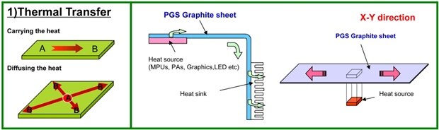

PGS film is used to transfer heat away from a heat source, or to diffuse or spread heat away from a hot spot (A>B) as shown in figure 4.

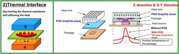

It can also be used as a highly-efficient thermal interface material as in figure 5.

Figure 7 demonstrates how heat can be transferred away from an IC (LED) to the casing in a camera design, reducing the heat sinking that is required.
Figure 8 shows how when applied in a IGBT or switching FET module, PGS acts as a thermal interface, reducing the thermal contact resistance and thermal soaking required.
