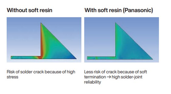

In addition to thin film resistors, Panasonic also provides a variety of thick film resistor technology. Panasonic thick film resistors are engineered to handle significant thermal and electrical stresses, making them suitable for demanding applications. One of the standout features of Panasonic's thick film resistors is the integrated soft termination, which is automatically included in components sized from 0201 and larger.
The soft termination technology is a game-changer in the market. It allows the resistor to expand and contract with temperature fluctuations, thereby mitigating the risk of solder joint failure. In battery management systems, in which components are subjected to varying temperatures and currents, without soft termination, solder joints can become brittle and fail, leading to potential system malfunctions.

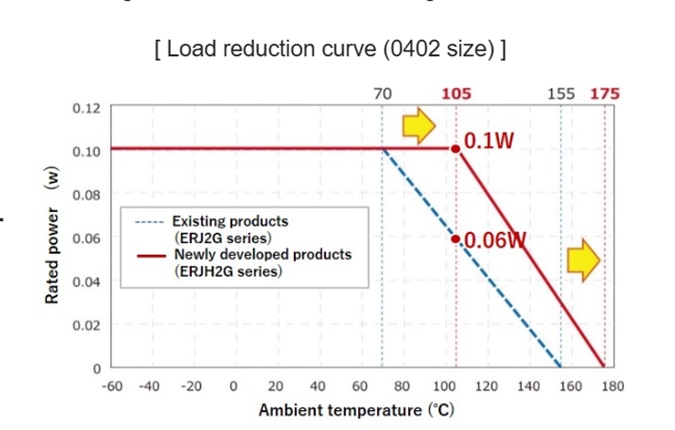

Part of Panasonic thick film resistors is high temperature technology, capable of withstanding maximum temperatures of up to 175°C. This capability is crucial for Battery Management Systems that may experience elevated temperatures due to high current loads. The concept of derating—with which the power capability of a resistor is reduced instead of 70° C at higher temperature of 105° C—becomes less of a concern and is particularly beneficial with high temperature resistor technology.
For instance, in a typical battery management scenario, temperatures can reach between 110°C to 125°C. Panasonic's thick film resistors allow for less power derating compared to standard components, ensuring that they can handle larger currents without compromising performance. This robustness makes them ideal for applications where reliability and durability are of vital necessity.

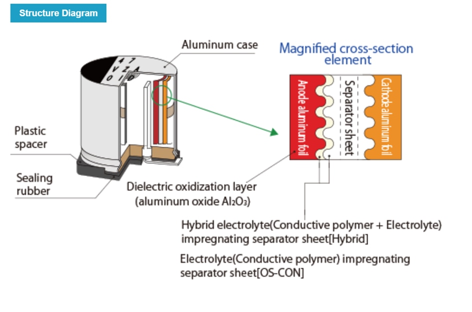

Panasonic's hybrid capacitors emerge is a vital component for BMS, combining the advantages of aluminum electrolytic and polymer capacitors. The essential advantage are their low leakage currents despite having high ripple current capability.
These hybrid capacitors are engineered to meet the demanding requirements especially of electric vehicles (EVs) and hybrid electric vehicles (HEVs), ensuring optimal performance, reliability, and safety.
Key Features of Panasonic's Hybrid Capacitors
Panasonic's hybrid capacitors are designed to deliver exceptional performance in various applications, particularly in battery management systems. Their key features include:
  • Low Equivalent Series Resistance (ESR): The low ESR of hybrid capacitors allows for efficient energy transfer, reducing heat generation and improving overall system efficiency. This characteristic is crucial in applications where rapid charging and discharging occur.
  • High Reliability: These capacitors are engineered for stability and durability, ensuring a high lifetime at application temperature and voltage. Their consistent performance under rigorous automotive conditions is essential for the safety and longevity of battery systems.
  • High Voltage and Large Current Handling: Panasonic's hybrid capacitors are designed to withstand voltage levels up to 80V while handling large currents, making them suitable for demanding applications in BMS and BDU (Battery Disconnect Unit) systems. This capability is vital for managing the energy flow in electric and hybrid vehicles.
  • High Heat Resistance: Featuring a robust construction that tolerates elevated temperatures, these hybrid capacitors operate effectively in high-heat environments, making them suitable for demanding applications such as automotive settings with frequent temperature fluctuations, meeting temperatures of up to 150°C
