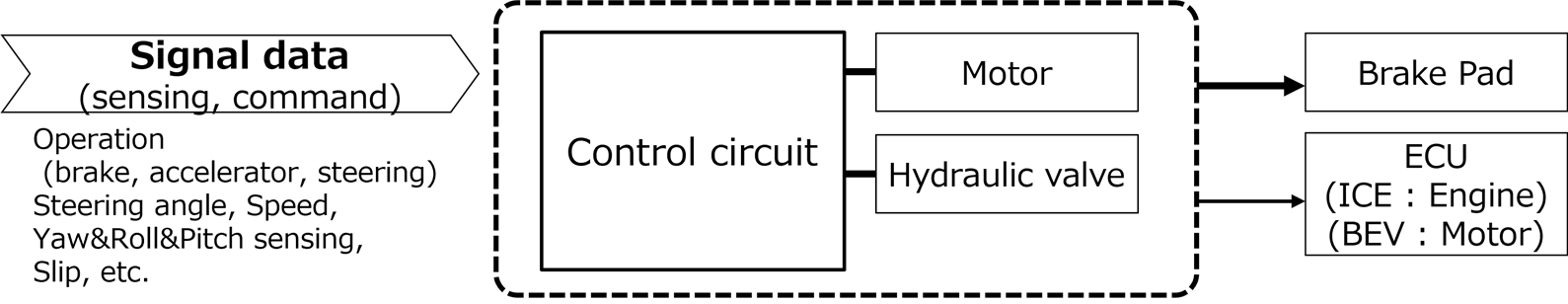

Role of ESC
(Fig. 1 Role of ESC)

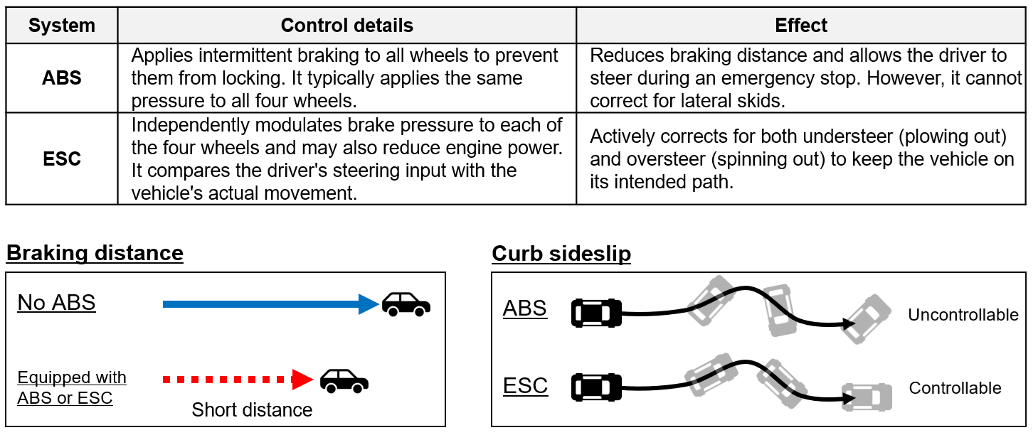

Distinguishing ESC from ABS
While often mentioned together, ESC and ABS have fundamentally different roles. The primary job of an Anti-lock Braking System (ABS) is to prevent the wheels from locking up when a driver brakes hard. This allows the driver to maintain steering control while braking and reduces the vehicle's skidding behavior, but it cannot control a vehicle's sideslip (lateral movement).
Electronic Stability Control, however, is designed specifically to prevent both slip and skids, giving the driver more complete authority over the vehicle's dynamics. Unlike ABS, ESC can actively manage sideslips, which is critical for maintaining stability through sharp curves or on uneven road surfaces.
Difference between ABS and ESC
(Fig. 2 Difference between ABS and ESC)

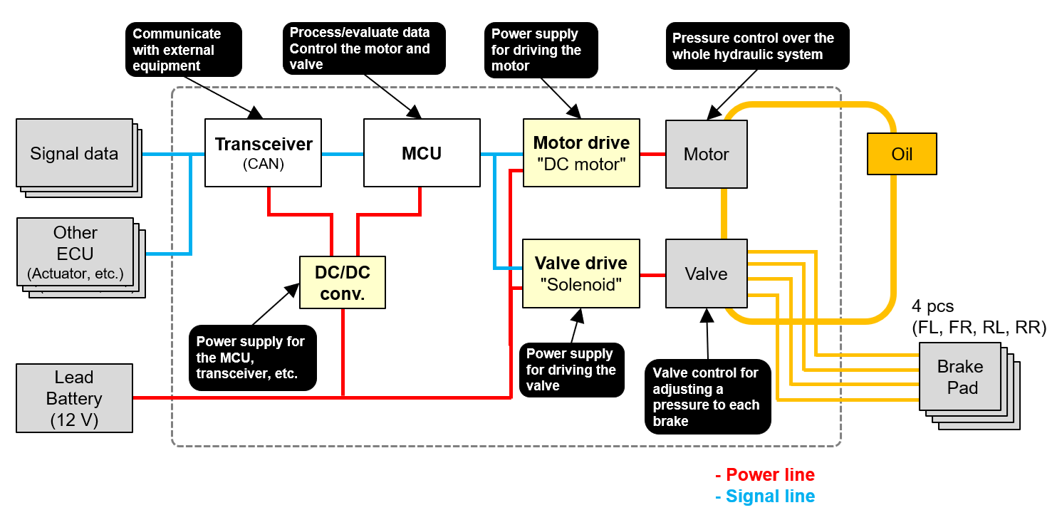

A Look Inside: The Circuit Configuration of an ESC System
The ESC system is a complex network of electronic components working in unison. A typical configuration includes:
  • Transceiver: A device or circuit that communicates with external equipment (through CAN).
  • Microcomputer (MCU): Processes/evaluates data, and controls the motor and brake pressure valve.
  • DC/DC converter: Supplies power to the MCU and transceiver.
  • Motor drive circuit: A power supply for driving the motor.
  • Valve drive circuit: A power supply for driving the brake pressure valve.
  • Motor: Controls the pressure of the whole hydraulic system.
  • Valve: Controls the pressure adjustment valve of each brake.
Overall configuration of the ESC
(Fig. 3 Overall configuration of the ESC)

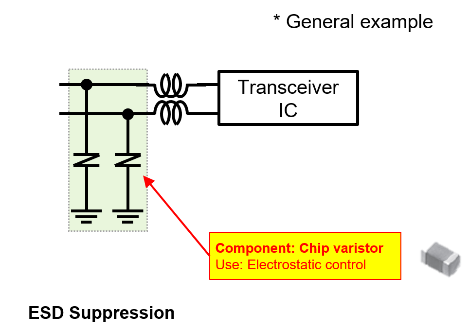

1. Transceiver Circuit
The transceiver facilitates communication over data lines (e.g., CAN, Ethernet). These lines are susceptible to external noise and electrostatic discharge (ESD), which can damage the transceiver IC. To mitigate this risk, chip varistors are commonly integrated as a protective measure against ESD events.
[Components used]
ESD noise elimination: Chip varistor
POINT
  1.  With a wide range of capacitance characteristics, the chip varistor suppresses electrostatic discharge (ESD) noise while keeping the communication quality of the circuit intact.
  2.  With its capacitance ranging from 8 pF to 250 pF, the chip varistor operates effectively at low and high communication speeds.
components used in the tranceiver
(Fig.4 Components used in the tranceiver)

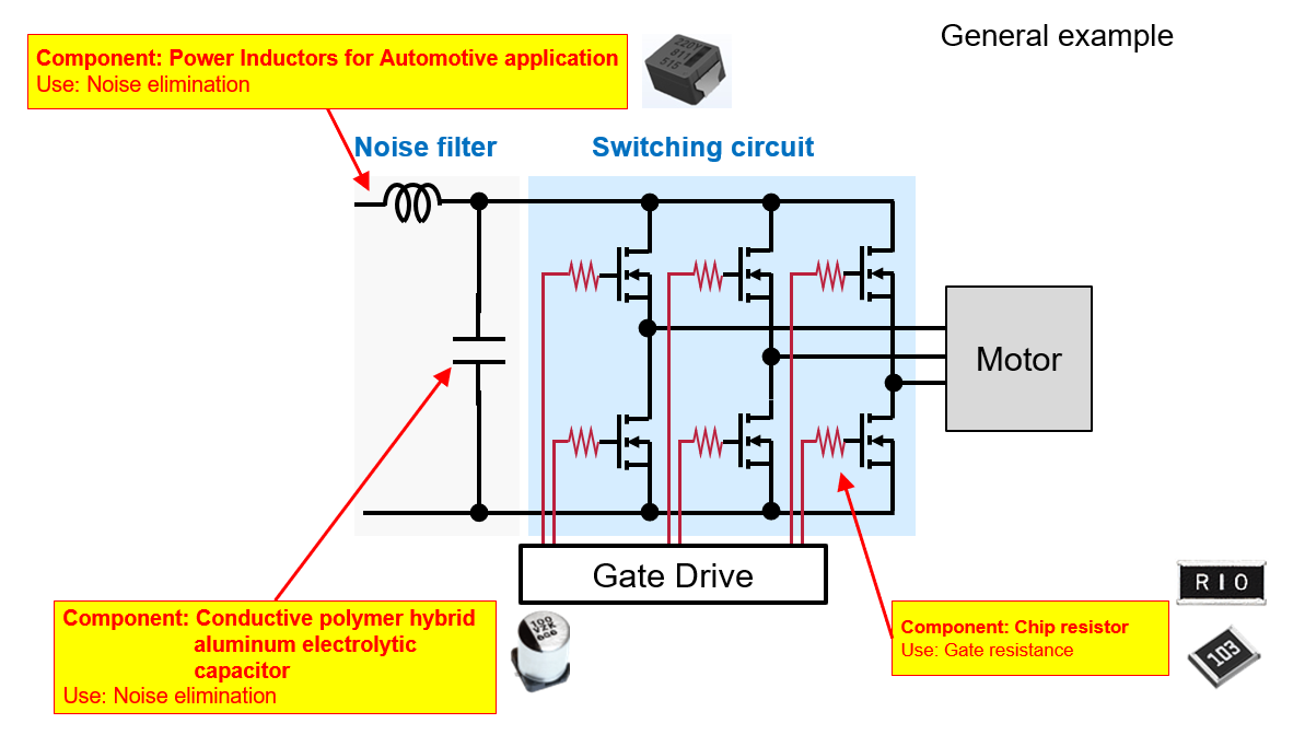

3. Motor Drive Circuit
This circuit uses switching elements (FETs) to convert voltage and drive the motor. The high-frequency switching action is a significant source of electronic noise. To manage this:
A noise filter, consisting of an inductor and a capacitor, is placed at the input to handle voltage fluctuations.
Gate resistors are connected to the switching elements to suppress noise generated during on/off transitions.
[Components used]
Noise elimination and smoothing: Conductive polymer hybrid aluminum electrolytic capacitor
POINT
  1. The capacitor offers high capacitance, low ESR, and high ripple-suppression performance, thus contributing to a reduction in the size of the circuit and an increase in the power capacity (low voltage and large current) of the circuit.
  2. Having capacitance characteristics that can cut off high-frequency components, the capacitor eliminates a wide range of high-frequency noises that are generated by a high-frequency switching of the circuit.
Noise elimination and smoothing: Power Inductors for Automotive application
POINT
  1. Inductors made of a metallic magnetic material suffer less power loss and carry a large current, thus contributing to a reduction in the size of the circuit and an increase in the power capacity (low voltage and large current) of the circuit.
  2. Having loss characteristics in a higher frequency range (low ACR), the inductor contributes to the suppression of power loss caused by high-frequency switching of the circuit.
Suppressing gate-driven noise from the switching elements: Chip resistor (small and high-power chip resistor)
POINT
  1. With its original resistance pattern, electrode structure, etc., the chip resistor is small in size and yet handles high-power operations, thus contributing to a reduction in the size of the circuit.
Components used in the motor drive circuit
(Fig. 6 Components used in the motor drive circuit)

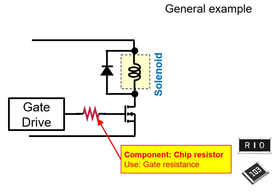

4. Valve Drive Circuit
The valve drive circuit controls the solenoid that actuates each brake valve. It consists of the solenoid itself, an FET for on/off control, and a diode to protect against voltage surges from the solenoid coil. Similar to the motor drive circuit, a gate resistor is used on the FET to suppress switching noise and ensure clean operation.
[Components used]
POINT
FComponents used in the valve drive circuit
(Fig. 7 Components used in the valve drive circuit)
