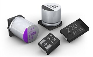

Recent advances in conductive polymers have resulted in new capacitors which either use polymers to form the entire electrolyte or in conjunction with a liquid electrolyte in a design known as a hybrid capacitor. Either way, these polymer-based devices can perform better than conventional electrolytic and ceramic capacitors in terms of their electrical characteristics, stability, longevity, reliability, safety and overall life cycle cost.
Polymer capacitors from Panasonic come in four main varieties and are discussed in the video:
SP-Caps
Layered polymer aluminum capacitors use conductive polymer as the electrolyte and have an aluminum anode. They range in voltage range from 2-35V and offer capacitances between 10-560μF. Their distinguishing electrical characteristic is an extremely low ESR - as low as 3mΩ, amongst the lowest in the industry. Packaged as compact surface mount devices, these devices have a low profile and suit applications in a variety of handheld electronic devices.
OS-CON
Wound polymer aluminum capacitors have a wound foil structure. Voltages extend from 2 to 100V, while capacitances run from 3.3 to 2700μF. Like the layered polymer capacitors, the wound style has extremely low ESR values - to below 5mΩ. The wound style devices can also be surface mounted, though they are not quite as compact as layered devices.
POSCAP
Polymer tantalum capacitors employ a conductive polymer as the electrolyte and have a tantalum anode. They span voltages from 2 to 35V and capacitances from 2.7 to 1500μF and again feature low ESR values down to 5mΩ. Packaged in a molded resin case, these devices are amongst the most compact on the market.
HYBRID
Polymer hybrid aluminum capacitors. As their name suggests, these capacitors use a combination of a liquid and conductive polymer to serve as the electrolyte and aluminium as the anode. Think of this technical approach as the best of both worlds: The polymer offers high conductivity—and a correspondingly low ESR. The liquid portion of the electrolyte, meanwhile, can withstand high voltages and provide higher capacitance ratings due to its large effective surface area. The hybrid capacitors offer a voltage range from 25 to 80V and capacitances between 10 and 330μF. At 20 to 120mΩ, ESR values for hybrids are higher than other types of polymer capacitors, but still very low considering the higher power applications they address.
