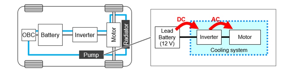

The cooling system pump is responsible for moving water through the cooling system, helping to prevent overheating of various equipment. This pump typically requires between 30 W and 100 W of power to function. It consists of an impeller, a motor, and an inverter, all housed in a cylindrical outer casing. In this article, we will explore the pump's functions, its configuration, and the electronic components that make it work.
Understanding the cooling system pump
In vehicles, the cooling system is designed to manage the heat generated by components like the battery and motor. It does this by circulating water through pipes in the cooling unit (also known as the jacket) surrounding these components. The pump forces water to flow through these pipes, and it generally operates with a power range of 30 W to 100 W. The main parts of the pump include an impeller, a motor, an inverter (which controls the motor), and a circuit board, all contained within a cylindrical casing.
Market trends and demand for cooling system pumps
As the number of vehicles—both electric and those with internal combustion engines—continues to rise, the demand for cooling system pumps in these vehicles is also expected to grow. Additionally, as equipment like batteries and inverters increase in power output, they generate more heat, leading to a greater need for efficient cooling systems and more powerful pumps.
To meet these needs, the electronic components in cooling systems must have key features: "high current capacity," "low energy loss," "high heat resistance," and "precise temperature control."
Circuit configuration of a cooling system with a pump overall setup

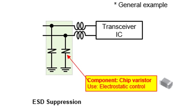

Communication interface: This circuit connects to external equipment via communication lines (like CAN or Ethernet). To protect against noise or static electricity, chip varistors are used to prevent damage.
Components used:
Chip varistor: It suppresses electrostatic discharge (ESD) noise without affecting the quality of communication.

    robogary over 1 year ago
    Dear author - This article leaves me really confused.
    The subject title refers to an EV cooling system example, however the topic drifts in and out of typical 3 phase inverter harmonic suppression and RFI discussion.
    The cooling system diagram infers the batteries, inverter , and motor are all liquid cooled. I knew batteries require temperature control, both heating and cooling , those I understood are forced air convection.
    Inverter and motors I thought were also air cooled, but I can see an advantage of liquid cooling to allow motors and inverters to use less heatsink and try to keep at constant temperature in both hot and cold environments.  It also adds back in the maintenance disadvantage that compare to ICE engines.
    At the article conclusion, the capacitor products listed have nothing to do with an EV cooling system, unless the imagination is stretched to include harmonic heating/suppression components.
    These comments are provided to be constructive feedback.   Best Regards
