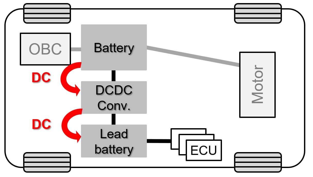

Electric vehicles (EVs) rely on two types of onboard batteries: a high-voltage lithium-ion battery and a low-voltage lead-acid battery. While the lithium-ion battery powers the drive motor and is charged via external charging stations, the lead-acid battery supports auxiliary systems and must be charged internally—from the lithium-ion battery. This is where the DC/DC converter plays a critical role: it transforms high-voltage DC power into low-voltage DC power, enabling safe and efficient operation of various vehicle systems.
Why DC/DC Converters Are Essential in EVs
Modern EVs are packed with electronic components—from ECUs and cameras to lighting systems—all of which operate on low-voltage power. However, the main drive motor requires high-voltage power (typically 400V or more) to reduce current flow and improve energy efficiency. Without a DC/DC converter, these systems would be incompatible with the vehicle’s power architecture.
Brief description of the DC/DC converter
High vs. Low Voltage Applications
  • High Voltage (400V+): Used for drive motors and other high-power systems. High voltage reduces current, minimizing energy loss and improving efficiency.
  • Low Voltage (12V): Powers auxiliary systems such as infotainment, lighting, and control circuits—even within high-voltage devices.

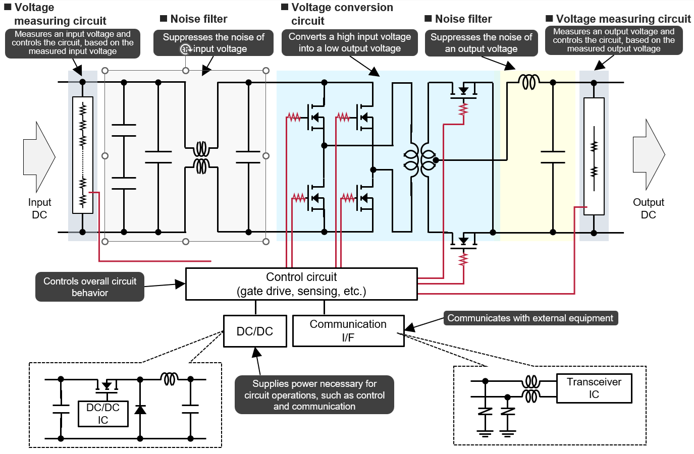

DC/DC Converter Circuit Architecture
A typical DC/DC converter consists of several key functional blocks:
  1. Voltage Detection (Input/Output): Measures voltage levels to control conversion accuracy.
  2. Noise Filters: Suppress electromagnetic interference using inductors and hybrid aluminum electrolytic capacitors.
  3. Voltage Conversion Circuit: Uses switching elements and transformers to step down voltage.
  4. Control Circuit: Manages switching operations and overall system behavior.
  5. Communication Interface: Enables external communication via CAN or Ethernet, protected by chip varistors against ESD.
Overall configuration of the DC/DC converter
Key Components Used
  • Film Capacitors: For input/output noise filtering
  • Hybrid Aluminum Electrolytic Capacitors: For smoothing and noise suppression
  • Automotive Power Inductors: For voltage conversion
  • High-Precision Chip Resistors: For voltage measurement
  • Chip Varistors: For ESD protection in communication circuits
