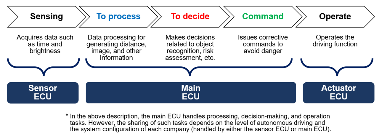

2. Core System Blocks Required for ADAS / AD
A complete sensing‑to‑control chain typically includes:
Sensor ECU
Cameras, RADAR, LiDAR, and ultrasonic sensors gather environmental data.
Main ECU / DCU
Performs high‑speed data fusion, perception, and decision‑making.
Actuator ECU
Controls braking, steering, powertrain, and other vehicle dynamics.
A DCU sits at the heart of this system, enabling seamless communication between domains and ensuring reliable autonomous operation.
Figure 1 Overall system flow (from sensing to operation)

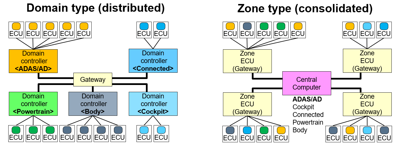

3. Domain vs. Zone Architecture—Where DCUs Fit
As OEMs evolve their E/E architectures, two major approaches are used:
Domain Type (Distributed)
  • Each function (ADAS/AD, powertrain, body, cockpit, etc.) has its own DCU
  • Processing is performed inside each domain
  • Domains communicate via gateway ECUs
Ideal for: Level 2 and Level 2+ applications
Zone Type (Centralized)
  • ECUs grouped by vehicle location (front, rear, cabin)
  • A central computer consolidates all zone‑level inputs
  • Supports massive data throughput and high compute requirements
Ideal for: Level 3–5 and next‑generation EV platforms
Configuration Connection Network
Domain type Consolidates domain-specific ECUs for each category (domain)
All domains are connected via the Gateway
Data processing is performed in each domain-specific ECU
Common network standards are used for communication between sensors and domains
Common network standards are used for communication between the domains and Gateway
Zone type Consolidates ECUs of different categories in each zone such as the front and rear of the vehicle
Consolidates data from each zone to the Central Computer
Integrates and concentrates data processing in the Central Computer
There is a mixture of different network standards for communication between sensors and zones
Common network standards are used for communication between the zones and Central Computer

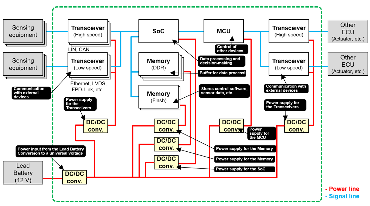

4. What Exactly Does a DCU Do?
A DCU integrates multiple functions:
  • High‑speed communication with sensors and other ECUs
  • Data fusion and environment recognition using SoCs and dedicated processors
  • Memory management (Flash, DDR) for algorithms and sensor data
  • Power management through multiple isolated DC/DC converters
  • Command execution to actuators and cooperating domains
This makes DCUs one of the most component‑dense areas in modern automotive electronics.

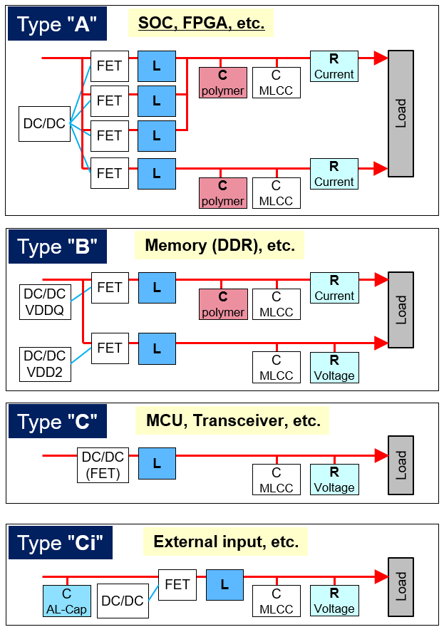

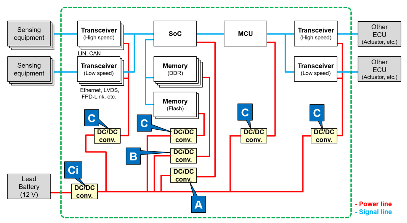

6‑2: Power Delivery—DC/DC Converter Architectures
DCUs require multiple supply rails to power SoCs, memory, MCUs, and transceivers. Panasonic components are essential for each converter block.
Figure 3 DCU system configuration
Three DC/DC Converter Types
Type Typical Use Characteristics
A (Multiphase) SoCs / FPGAs Very high current, polymer capacitors + MLCCs
B DDR memory High ripple current, large‑capacitance smoothing
C General rails Standard DC/DC topology

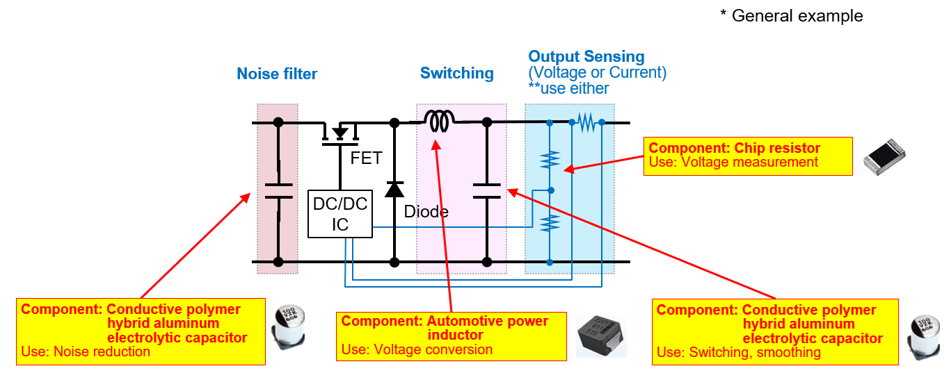

Key Panasonic Components for DC/DC Converters
① Conductive Polymer Hybrid Aluminum Electrolytic Capacitors
  • High capacitance, low ESR
  • Excellent high‑frequency performance for noise suppression
  • Supports miniaturization and high‑current operation
Arrow forward Farnell® UK
Figure 5 DC/DC converter circuit configurations by load type
Figure 6 Components used in a DC/DC converter
② Automotive Power Inductors
  • Low loss thanks to metallic magnetic materials
  • High current capability
  • Optimized for high‑frequency switching
Arrow forwardETQP Inductors | Farnell® UK
③ High‑Precision Chip Resistors
  • Low TCR and low resistance tolerance
  • Suitable for voltage sensing feedback loops in converters
Arrow forward ± 0.05% PANASONIC Chip SMD Resistors | Farnell® UK
