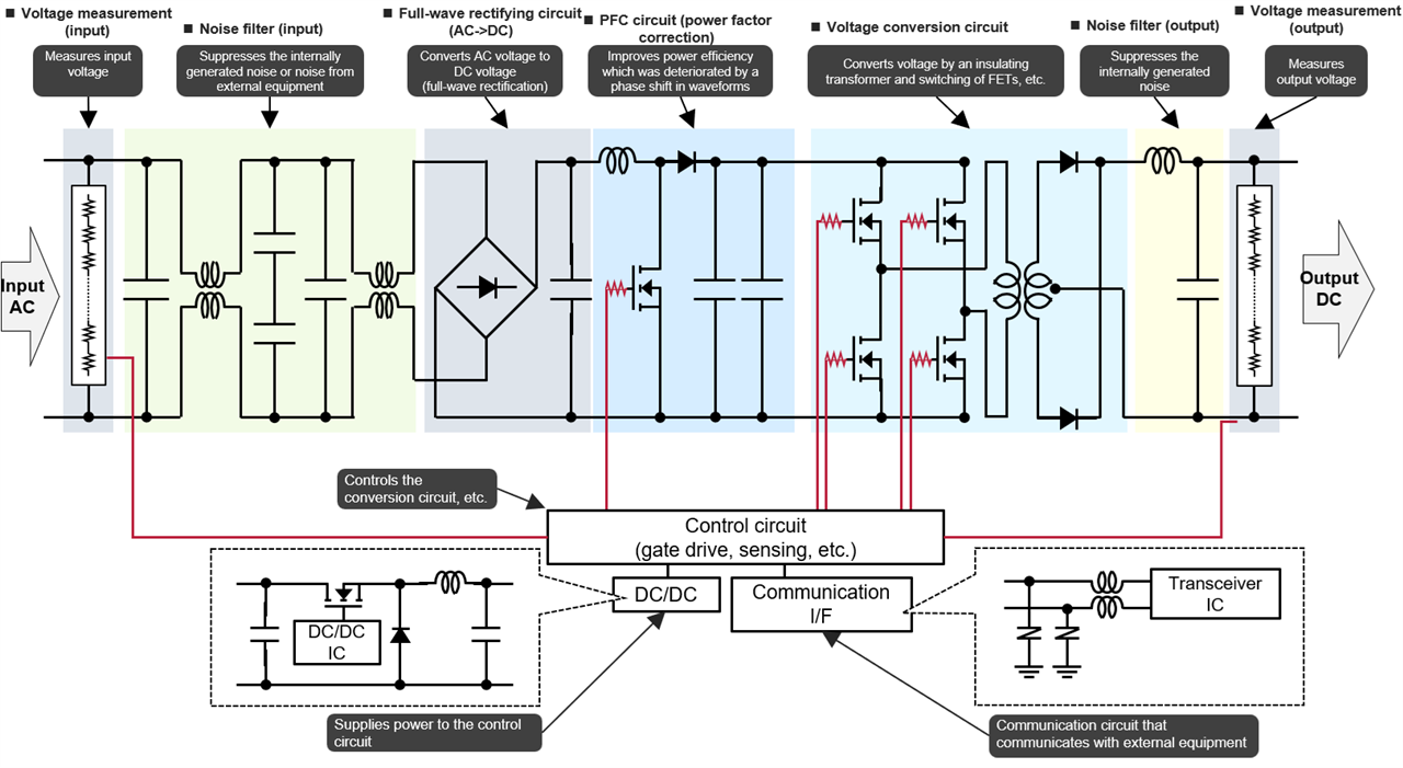

OBC System Architecture
The OBC system consists of multiple circuits:
  1. Voltage Measurement (Input/Output) – Controls conversion accuracy using high-precision chip resistors.
  2. Noise Filters (Input/Output) – Suppress external and internal noise using automotive-grade film capacitors.
  3. Full-Wave Rectifier & PFC Circuit – Converts AC to DC and improves efficiency using capacitors and inductors.
  4. Voltage Conversion Circuit – Uses transformers and switching elements with noise-suppressing resistors.
  5. DC/DC Converter – Powers control circuits using hybrid aluminum electrolytic capacitors and power inductors.
  6. Communication Interface – Protects transceiver ICs from ESD using chip varistors.
Overall configuration of the OBS system
