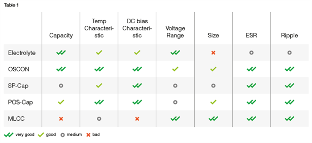

MLCCs have been relied upon and used across multiple industries as a trustworthy workhorse. The most cost effective solution had been and probably would continue to be for the next ten years; the stacking of ceramic, but anywhere that other dielectrics can be employed, demand will grow as manufacturers have no choice but to distance themselves from such a tremendous reliance on Ceramics. Table 1 shows various kinds of capacitors including electrolytic capacitors, OSCON, SP-Cap, POS-Cap, film capacitor and MLCCs. The application typically dictates the best choice of capacitor type to use in the design. But before we get to that, generally speaking, the following differentiation can be made: whilst electrolytic capacitors provide the largest ESR these capacitors suffer significant degradation in capacitance and dry-out at higher temperatures and frequencies. Ceramic capacitors have a very low ESR and ESL that makes them great for transient performance but they have limitations on capacitance due to derating. Though ceramic capacitors can operate at very high ripple currents,  they suffer the non-graceful aging failure and require lower operating electric fields. Polymer electrolytic capacitors are mainly used in power supplies of integrated electronic circuits as buffer, bypass and decoupling capacitors, especially in devices with flat or compact design. Thus they compete with MLCC capacitors, but offer higher capacitance values and display no microphonic effect. Panasonic is a leading manufacturer of Solid Polymer Aluminum Capacitors: SP-Caps and OS-CON, Tantalum Polymer Capacitor – POS-CAP as well as Polymer Hybrid Aluminum Electrolytic Capacitor technologies and has the longest design-in expertise and experience on the market. Conductive polymer aluminum solid capacitors, abbreviated to “polymer capacitors” in the following, have been extending in their application. The polymer capacitor (as well as conventional aluminum electrolytic capacitors) are featured by large capacitance and excellent bias characteristics which multilayer ceramic capacitors can never compete with. In addition to these advantages polymer capacitors have extremely low ESR characteristics. Regarding ESL, which is determined by inside structure and terminal configuration of the capacitors, by making structural improvements, the polymer capacitors can have low ESL. Also concerning the dry-out of electrolyte in service life and the changes of characteristics at a range of low temperatures the polymer capacitors have realized very high reliability and superior low temperature characteristics by using solid polymer materials as an electrolyte.
Especially the SP-CAPs and POS-CAPs with their small size factor and cubical form are the go-to products when it comes to the replacement of MLCCs. By looking closer at the characteristics of these different technologies once can see some major differences between them.

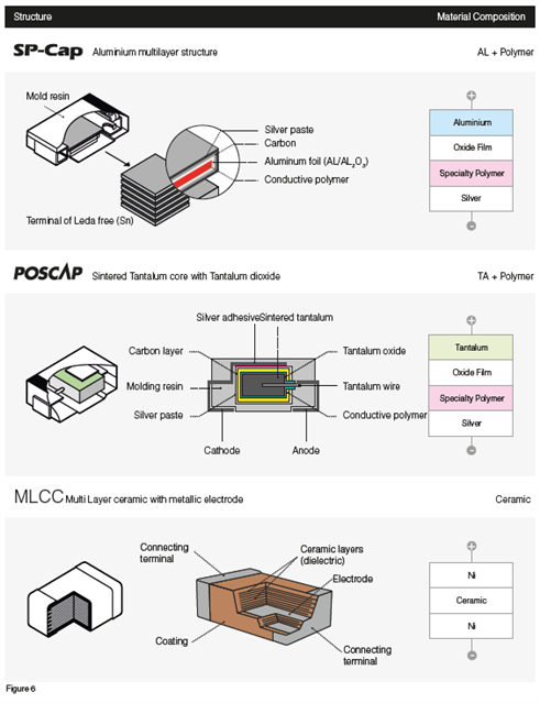

Most ceramic capacitors have a fairly high voltage rating. If the capacitor experiences a voltage between its terminals higher than its rated voltage, the dielectric may break down and electrons will flow between the thin metal layers inside of the capacitor, creating a short. Luckily, most ceramic capacitors are built with a hefty safety margin and do not experience any sort of catastrophic failure (such as exploding). However, the rule of thumb dictates that you should derate ceramic capacitors by 50%, which means that if you are expecting to have a maximum of 5V between the capacitor’s leads, then you should use a capacitor rated for 10V or more. In order to understand the lifetime properties of polymer vs. MLCCs you have to take the construction and properties of each one into account (Please also compare figure 6). Polymer capacitors are coming as chip type or wound type products. Since solid polymer capacitors are not regarded as components which are likely to be replaced in a device, they are often made in SMT (Surface-Mount-Technology). This allows them to take up less space on the PCB at the expense of being harder to unsolder if replacements are necessary. However, adopting SMT technology overall for a PCB also allows automated mounting, reducing costs and minimal human interference. The use of solid electrolyte is a major advantage over electrolytic capacitors. In a wet electrolytic capacitor overheating can cause the electrolyte to evaporate. As it evaporates, pressure builds up within the capacitor and it may burst or even explode. Solid polymer capacitors don’t have such risks– the capacitor starts acting like an open circuit towards the end of its lifetime with decline in capacitance or increase in ESR. Generally speaking, the reliability of polymer capacitors is much better than the reliability of electrolytic capacitors and particularly MLCCs.

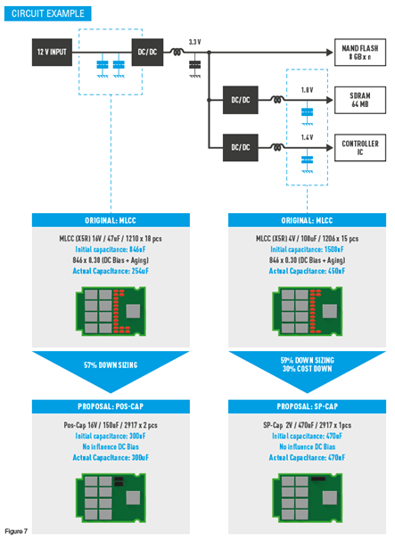

User Case
The comparison of the characteristics outlined above is only partial in nature. Each type of capacitor is well suited to some fields and poorly suited to others. When actually designing circuits it is necessary to consider a number of factors on addition to the characteristics described above, such as cost and size, in order to select the best capacitor for the job if space is limited, all-purpose MLCCs are the best. MLCCs are also suitable for applications where the ability to deal with very high voltages is needed because of their high withstand voltage performance and ability to withstand reverse voltage. Typical polymer capacitors are a good choice when both, higher capacitance and low ESR are important. Especially the potential cost and space saving when comparing single polymer capacitors to an equivalent of multiple MLCCs can make a big difference in designing PCBs. Taking these considerations into account we define following target specs for MLCC replacements with polymer capacitors:
  • Voltage Lines: 16 to 35V
  • Capacitance: 47μF to 560μF (and since large capacitance is THE strength of polymer capacitors – the higher the better)
  • Preferably B & D case sizes
