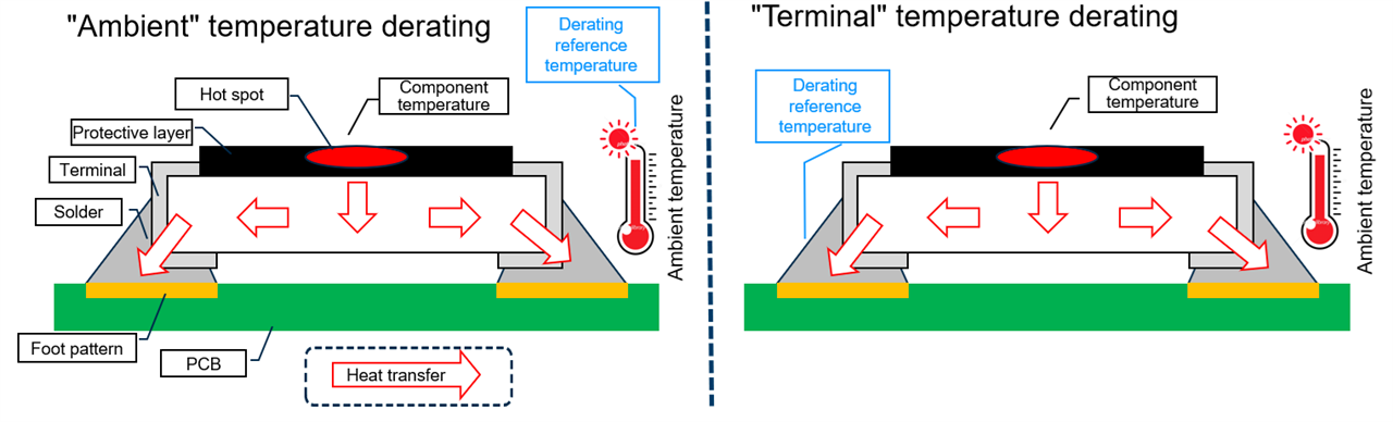

2. Why Terminal‑Temperature‑Based Specification Is Becoming Essential
To solve this mismatch, manufacturers—including Panasonic Industry—have adopted a more precise method: measuring power rating based on terminal temperature rather than ambient air temperature.
This approach allows engineers to:
  • Quantify the exact thermal load applied to a resistor during operation
  • Reduce design uncertainty caused by complex heat flow within a dense PCB
  • Improve prediction accuracy for component lifetime and failure risk
The trend has grown strong enough that industry organizations such as JEITA have begun issuing study reports and guidance documents, including RCR‑2114: Study for the derating curve of fixed surface‑mount resistors, which Panasonic follows when defining its product specifications.
Conceptual diagram

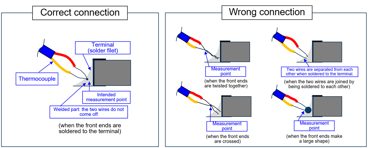

3.2 How to Prepare and Attach a Thermocouple Correctly
To ensure accurate readings:
  1. Properly weld the wire tips
    • Twisting or soldering the wires together is not enough
    • Use spot‑welding to form a small, stable junction
  2. Avoid oversized or crossed wire tips
    • An oversized joint or a stray wire can act as a heat sink
    • This causes temperature readings to fluctuate or drop artificially
  3. Attach precisely to the center of the solder fillet
    • Placing the junction near the edge or outside of the fillet compromises accuracy
    • The thermocouple must be exactly at the intended thermal reference point
Panasonic’s evaluation examples emphasize correct positioning, as shown in their measurement diagrams.

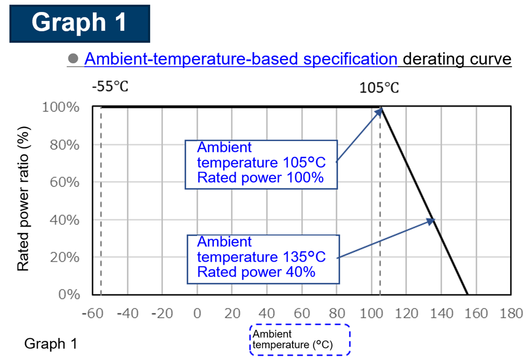

Panasonic Industry provides both ambient‑temperature‑based and terminal‑temperature‑based ratings in many resistor datasheets. A sample from the ERJPA3 (0603) series illustrates how both specifications coexist:
Ambient‑Temperature‑Based Derating Example
  • 105 °C → 100% rated power
  • 135 °C → 40% rated power

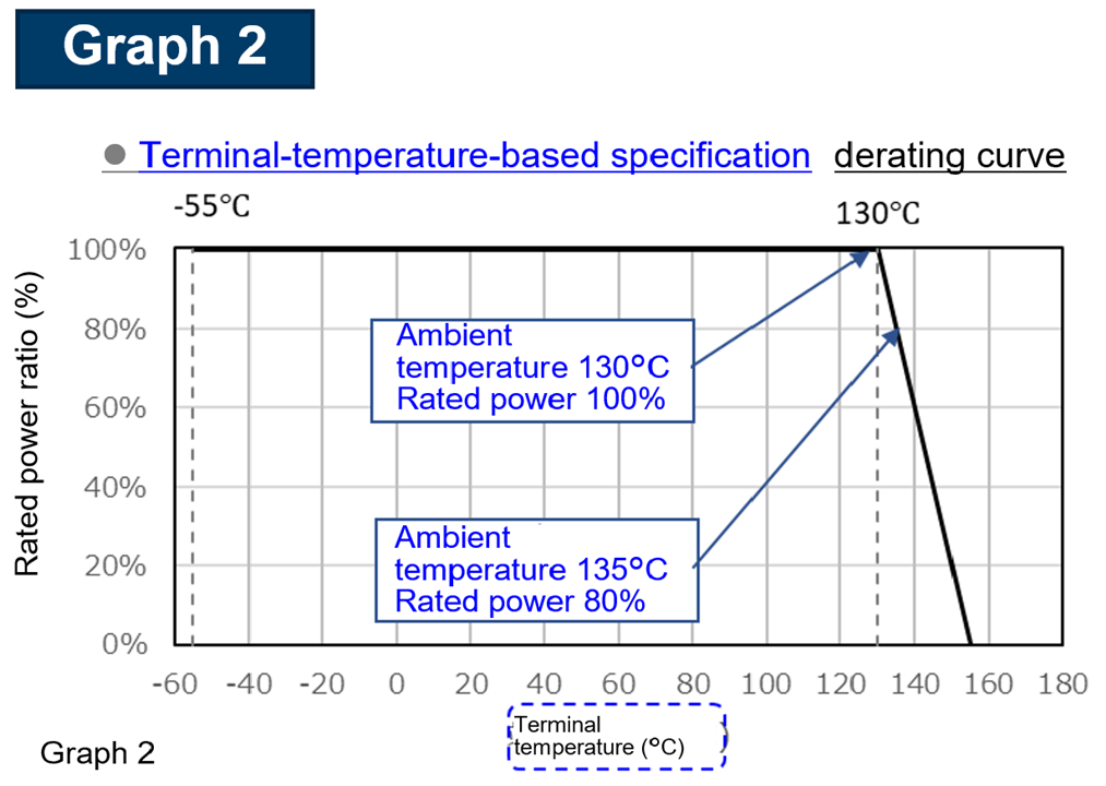

Terminal‑Temperature‑Based Derating Example
  • 130 °C → 100% rated power
  • 135 °C → 80% rated power
In cases where both ratings are listed and the design environment is complex (high density, high heat flow), Panasonic recommends prioritizing the terminal‑temperature‑based rating for greater design accuracy.
ERJPA3 series catalog (which shows product specifications as of April 2023)
ambient-temperature-based specification derating curve
terminal-temperature-based specification derating curve
