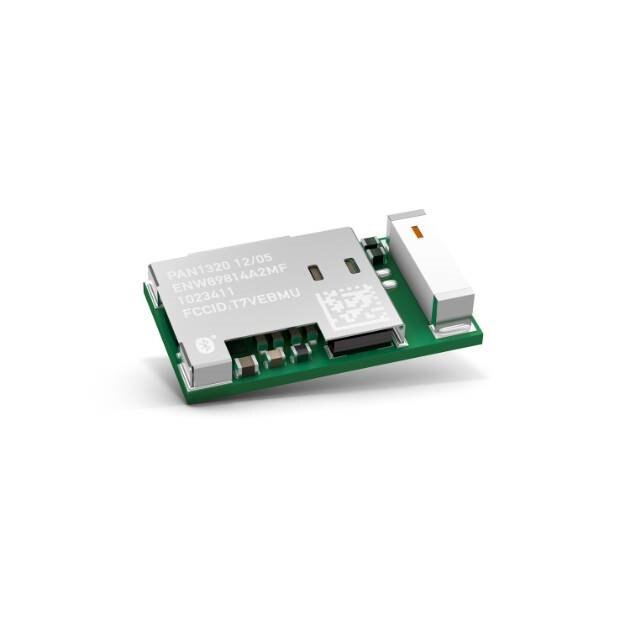

Introducing the PAN1721, a complete power optimized Bluetooth v4.0 Low Energy (BLE) solution
Introducing the PAN1721, a complete power optimized Bluetooth v4.0 Low Energy (BLE) solution, this module includes an embedded processor, antenna and BLE stack. The PAN1721 is engineered for ultra low power consumption applications.
The PAN1721 is a cost-effective, ultra low-power, system-on-chip (SoC) for Bluetooth Low Energy applications. The module includes an eight channel, twelve bit analog-to-digital converter, 19 GPIOs plus battery and temperature sensors. A single device for both BLE master or slave nodes. The PAN1721 combines an excellent RF transceiver with a high performance low power 8051 microcontroller, in-system programmable flash memory, 8-KB RAM, and many other powerful supporting features and peripherals.
The PAN1721 is an ideal choice for applications where battery life is a critical application requirement, using only 500 nA in sleep mode. Short transition times between operating modes–3 uS Wake-Up – and power efficient hardware further reduce current consumption.
Panasonic offers Bluetooth Low Energy protocol stacks and applications from Texas Instruments and BlueRadiosimage. The BlueRadios stack enables rapid and low cost development using an AT command set without the need for a compiler. Additional advantages include UART programming, over-the-air-updates, easy integration “C” library framework, serial streaming of data, and smart phone libraries and applications
Product Performance:
  • Bluetooth 4.0 Compliant and Bluetooth Low Energy
  • Dimensions: 14.5x 8.2 x 3 mm
  • Supports User Developed Applications
  • Texas Instruments’ Stack or Optional BlueRadios Stack
  • 256K Flash, 8K RAM
  • Supports 1 Mbps Data Rate
  • Temperature Range -40°C to + 85°C
  • Eight Channel 12-Bit ADC
  • 19 GPIOs
  • Battery Monitor and Temperature Sensor
