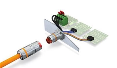

Written by Duncan Nicol, Market Segment Manager- Device Connections.
Industrial automation is increasingly reliant on data exchange for a host of applications including efficiency improvements and traceability. Machine builders are in turn looking at ways to improve machine performance and reduce assembly and installation costs.
The new M23 Hybrid connector solution from Phoenix Contact offers a new approach to provide signal, data and power to machines with exceptional performance and cost saving potential. With 4 signal, 4 CAT5 data, and 4 power + PE contacts housed in a single connector, the M23 Hybrid enables daisy chain connectivity to decentralise control and reduce device cabling.
M23 Hybrid features include:
  • 4 Signal up to 8A, 50V.
  • 4 Data CAT5 (optional unshielded 4 pole signal insert).
  • 4 Power + PE up to 30A, 850V DC / 630V AC.
  • IP67/69 protection.
  • Temperature range: -40°C to +125°
The product portfolio comprises cable connectors, couplers, straight & angles device connectors, and over moulded cable assembles made to order. The connectors feature SPEEDCON fast connection technology.
The M23 Hybrid offers machine builders and device manufacturers a new solution to reduce cabling and save space on the device and in the cable tray.
