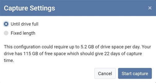

As part of the setup, the Picolog Software shows the free space available and calculates the capture time, in this case, 22 days (Dependent on the sample rate)

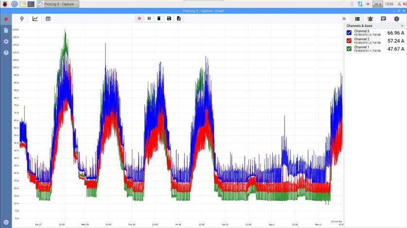

A week later the Pi was accessed remotely using a VNC connection and a PicoLog data file downloaded.
Here we see a week's worth of data with each phase colored Green, Blue, and Red.
The working days stand out clearly compared to the weekends where there is little power being consumed.

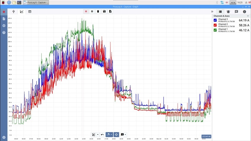

By zooming in to one day we can see more detail:
Night time shows the main HVAC system switching on and off and also irregular spikes that might be smaller temperature control units separate from the main system.

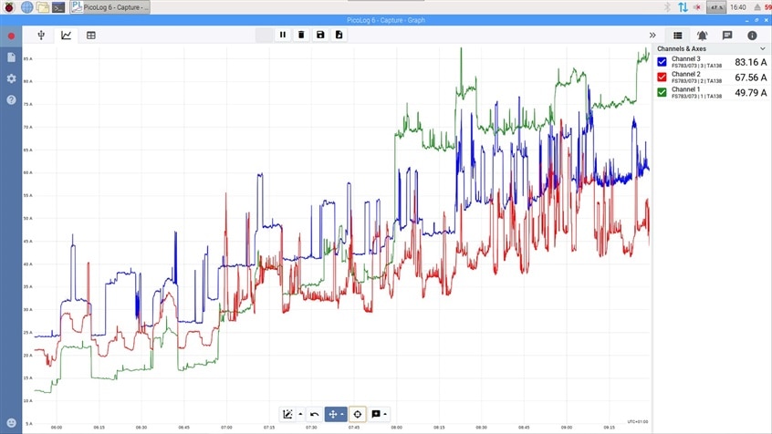

Zooming in further we can see the current draw rising with the arrival of the early bird employees after about 6.30 am, as kettles are boiled and computers and soldering irons are turned on.
At about 8 am we see an increase in the green phase when an employee connects his electric car to one of the charging points, this falls back in the afternoon once the car is charged.
The record gives us a lot of insights into how and when energy is being consumed and could help us be more energy efficient.
