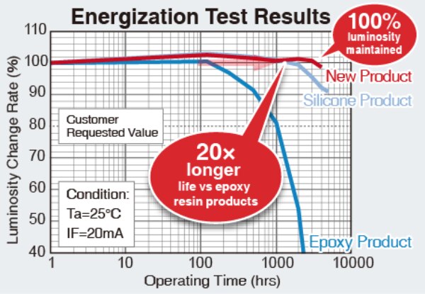

1) 100% luminosity maintained after 1,000hrs
100% luminous intensity was successfully maintained during energization testing (1,000hrs). The result is approx. 20x longer life with regards to the residual ratio at the same light intensity vs epoxy resin.

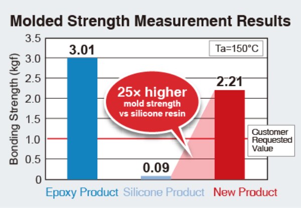

2) 25x higher mold strength
Mold strength is improved by 25x compared with silicone products even at high temperatures. This ensures exceptional mountability.
