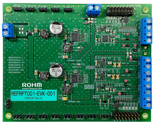

A system-level evaluation board that combines ROHM's IC and discrete products.
We have already solved not only the characteristics of individual products but also the problems
that may occur when combining them to build a system, thus contributing significantly to the reduction
of development time for our customers.

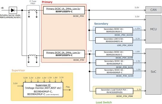

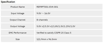

This reference design is a power tree solution board developed for infotainment devices
such as automotive clusters and center information displays and for ECUs for ADAS application.
The power system that can support functional safety is integrated on a single board to achieve
the optimal configuration as a power tree. Excellent EMC performance that meets CISPR25 Class 5
even at all power supply rails are enabled, and reduces heat generation of each device by
distributing high-efficiency DCDCs. In addition, two supervisor ICs with self-diagnosis functions
can monitor the output of all power rails and contribute to a higher level of functional safety.
BD9P105EFV-CBD9P105EFV-C
BD9S201NUX-CBD9S201NUX-C
BD00IA5MEFJ-MBD00IA5MEFJ-M
BD9P205EFV-CBD9P205EFV-C
BD9S400MUF-CBD9S400MUF-C
BD9S300MUF-CBD9S300MUF-C
RV4C020ZPHZGRV4C020ZPHZG
RBR3LAM60BTFRBR3LAM60BTF
BD39040MUF-CBD39040MUF-C
