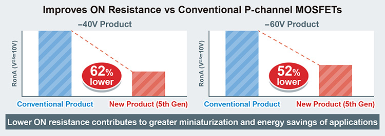

Against this backdrop, ROHM developed low ON resistance -40V/-60V P-channel MOSFETs compatible with 24V input utilizing advanced 5th gen refined process. Based on ROHM’s market-proven P-channel MOSFET structure, these new products leverage refined process technology to achieve the lowest ON resistance per unit area in their class. This translates to 62% lower ON resistance vs conventional products for -40V new products and 52% for the -60V new products.

These new products utilize ROHM’s 5th gen refined process to achieve a finer gate structure and higher current density than ROHM’s conventional products, resulting in the class-leading low ON resistance per unit area for 24V input -40V/-60V withstand P-channel MOSFETs. 62% lower ON resistance vs conventional products for -40V new products and by 52% for the -60V new products contribute to greater energy savings and miniaturization.

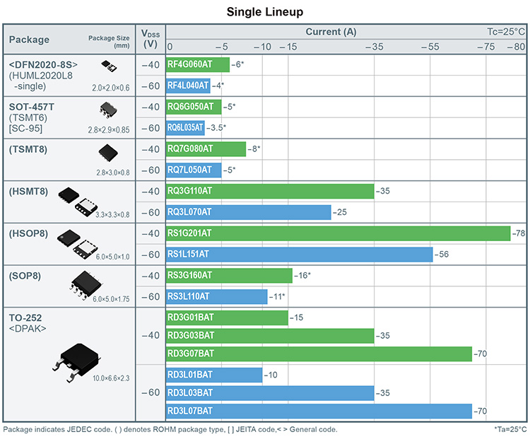

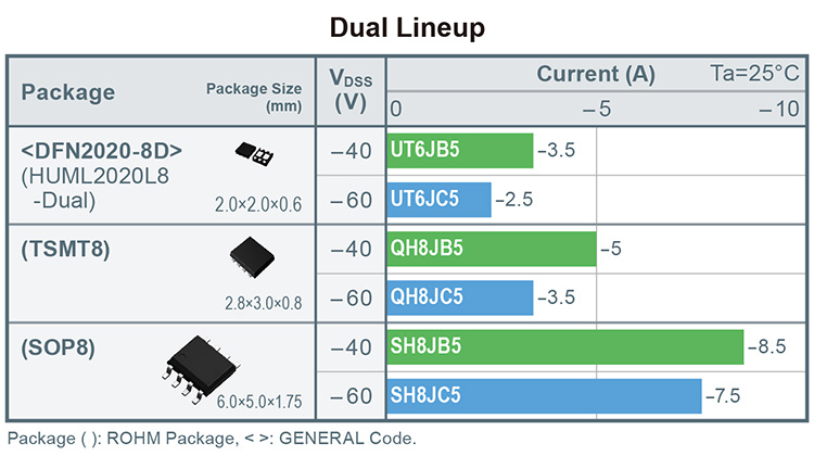

Single LineupDual Lineup
Dual Lineup

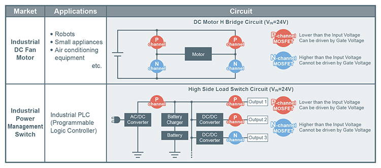

  • Power management switches and fan motors for industrial equipment, such as factory automation, robotics, and air conditioning systems.
  • Power management switches and fan motors for large-scale consumer equipment
Application and Circuit Diagram
