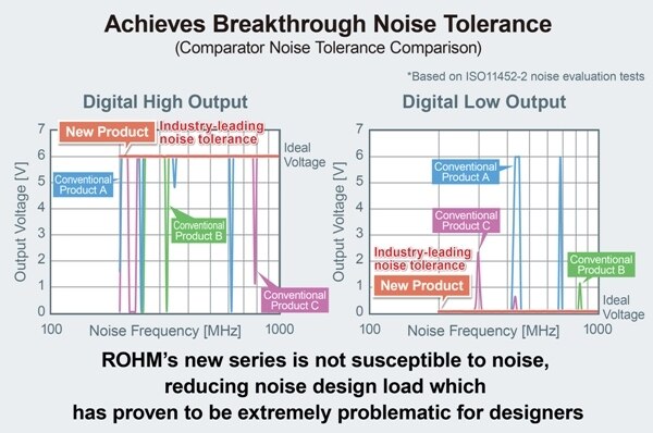

Unlike conventional products whose output may fluctuate due to noise, ROHM comparators ensure an output voltage fluctuation of just ±1% across the entire noise frequency band.
This makes it possible to accurately determine the sensor signal thresholds (High/Low), preventing malfunction.

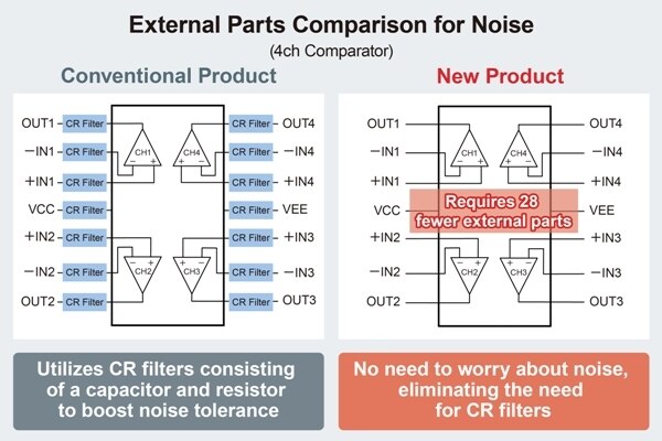

Reduces the number of external components required by conventional products for noise countermeasures.
For example, for a 4ch comparator, 28 fewer parts are required, reducing the design load for noise countermeasures.

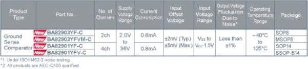

Industry-standard package enables easy replacement in applications sensitive to noise.
BA82903YF-CBA82903YF-C BA82903YFVM-CBA82903YFVM-C BA82901YF-C BA82901YF-C BA82901YFV-CBA82901YFV-C
