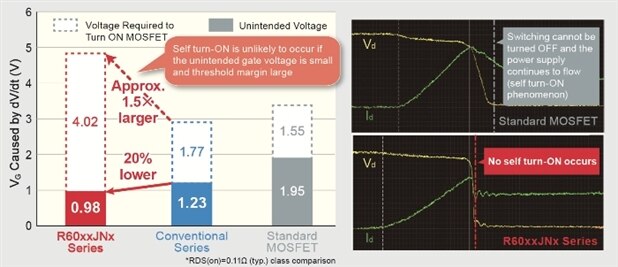

(Feature 1)
Reduces unintended gate voltage during switching by 20%. Also, increasing the threshold voltage by 1.5x reduces the likelihood of self turn-ON, expanding the loss adjustment range (i.e. via gate resistance).

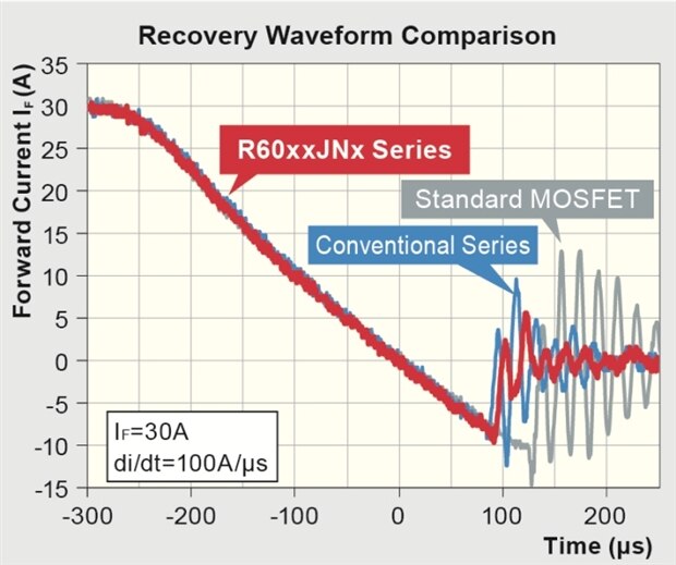

(Feature 2)
Improves hard recovery characteristics and reduces the risk of noise-induced malfunctions while maintaining fast reverse recovery time.
