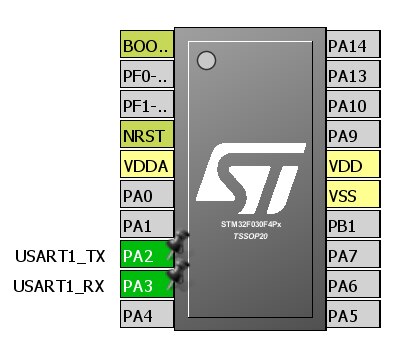

I am using a STM32F030F4 chip. This chip has one UART and one I2C.
I want to have the UART always connected to a usb to serial chip for firmware upgrade via the bootloader. But I wanted to use the I2C as well for some sensor.
From CubeMX I see there are two set of pins that can be used for UART.
As default I see UART on PA9 and PA10. Pins.PA9 and PA10 are the pins used for I2C.
The CubeMX let me change UART to PA2 and PA3,
My Question is:
Can I change the chip bootloader so I have PA2 and PA3 as UART and leave PA9 and PA10 open for I2C ?
This is how I would like to be on bootloader.
Thought that if this can be changed for run mode, should be possible to change for bootloader, but I do not have the factory bootloader source code to change it.
I would like to stay with a bootloader similar to the one from factory to keep official tools compatibility. But wanted the UART to move from PA9-PA10 to PA2-PA3 if possible.
I am totally new to STM32, this is a shot in the dark in case it is possible.
Any comment is welcome.

    You can't boot on PA2/3 (check out ST AN2606, page 29 - this is the bootloader documentation for STM32 family). You could bit-bang the I2C on any pair of IO pins - what chip is on I2C and how often do…

    Thanks very much. Seems that I will be stuck with those pins for UART.
    If I for some reason mess up the bootloader on a STM32 chip, can I reload it or at least take it out from one chip and copy to another? With these STM32 chips I have not found actual binaries for bootloader neither it's code. The process is well documented but not actual official code.
    I wanted to talk possibly to up to two other chips.
    There are two possible chips to talk to. The rate at which I'll be reading from these devices may vary but it can be pretty slow.
