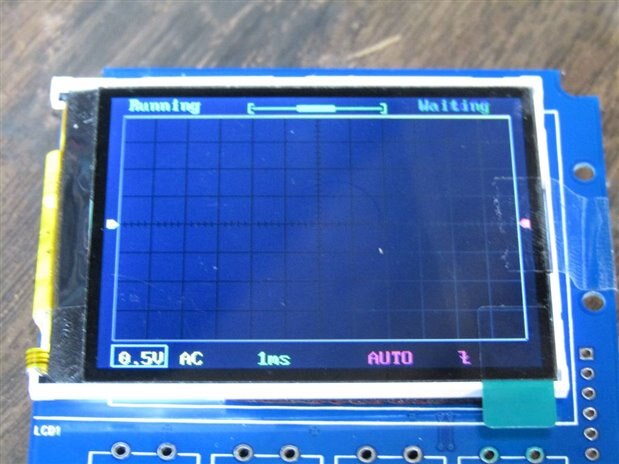

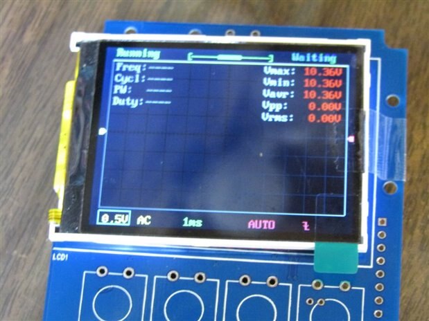

    This is just an update. The STM 32 microprocessor arrived today and I installed it on the board as well as all the parts I had removed to trace the original short. The chip comes with a pre-installed bootloader…

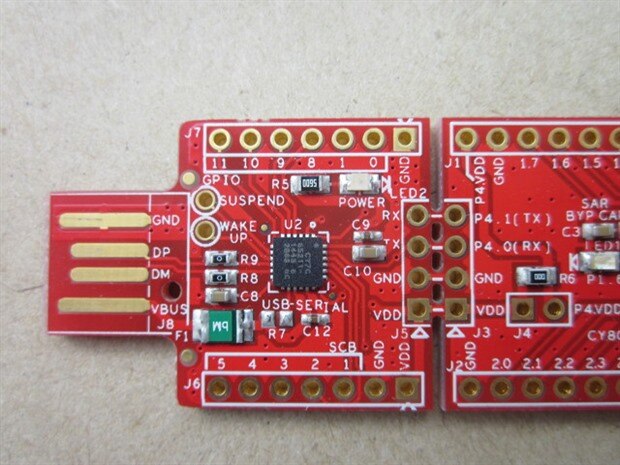

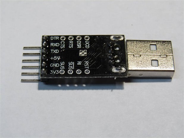

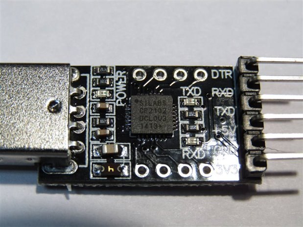

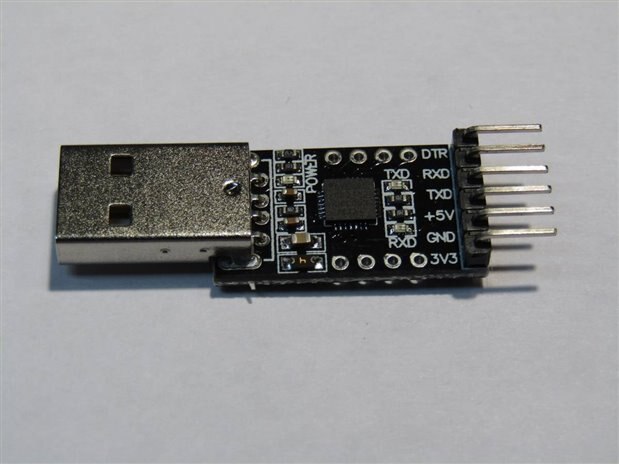

    Here's a USB to UART that would work from  a PC: FTDI Cable
    • Reject Answer
  • jc2048
    0 jc2048 over 9 years ago in reply to Jan Cumps
    Here's another one that doesn't cost much - you even get a free, snap-off, PSoC 4 processor board with it!
    It's a CY8CKIT-049-42xx but the I/O is all 5V so it would need level conversion and some of the other suggestions are probably better
