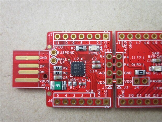

    0 jc2048 over 9 years ago in reply to Jan Cumps
    Here's another one that doesn't cost much - you even get a free, snap-off, PSoC 4 processor board with it!
    It's a CY8CKIT-049-42xx but the I/O is all 5V so it would need level conversion and some of the other suggestions are probably better

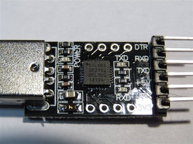

    0 jw0752 over 9 years ago in reply to Jan Cumps
    Hi Jan,
    As I was searching the internet for the shortest easier solution last night I remembered that I had a UART that I used a couple years ago to program an Arduino Mini Pro. Here are pictures of it:
    As you can see it is just like the one you recommended without the cord. It is based on the Silabs CP2102.
    NOTE: I have need of a clarification:
    As long as we are talking I have a clarification question on these UARTs. Most of them have a way of choosing 5V or 3.3V. I am assuming that this is strictly for supplying power to the unit that is being programmed and has nothing to do with logic levels that the UART supplies. This one has 3.3V logic levels and it worked well with my 3.3 V STM 32 microprocessor. If however I was trying to use it on a chip that used 5V logic levels I might have a problem and would have to use a 3.3V to 5V logic converter. I have written this as statements but I need reassurance that I have the right idea about what I have said.
    Thanks

    0 gecoz over 9 years ago in reply to jw0752
    Hi John,
    Your statement is absolutely right. UART devices can use different voltages for their logic levels, while still implementing the same communication protocol. In your case, the logic levels of the STM32 UART are 0V low, 3.3V high, so your USB to UART converter was OK. But if you were to use it to interface USB with a TTL UART  device (like the Arduino UNO UART for instance), you would have needed a logic level converter, as TTL logic works with 0V low and 5V high levels.
    Fabio.
