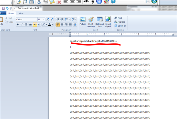

I am developing on the STM3240G-EVAL and am using the 3.2" TFT color LCD. I am trying to change the display that is on the LCD to a logo for the company that I am working at so when you turn it on, the LCD displays it by default. We purchased the development board pre-programmed with an example on it so that when I turn on the board their logo shows up on the LCD.

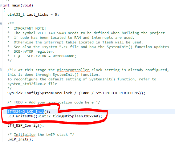

I have been attempting to reverse engineer the board to find how I could simply replace their picture with mine. I read through main.cpp and stepped through the program line by line and believe this is whats happening;
the LCD is initialized with STM324xG_LCD_Init()

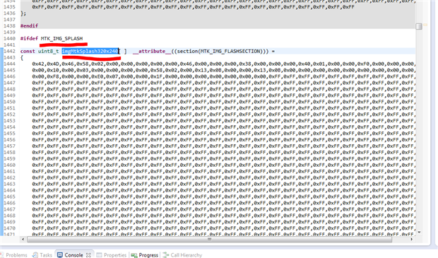

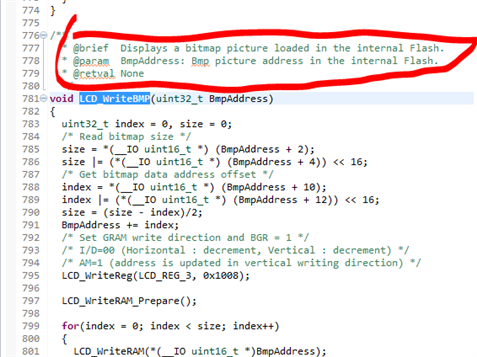

LCD_WriteBMP((uint32_t)imgMtkSplash320x240)  Displays a bitmap picture loaded in the internal Flash.
And when I check the declaration of ImgMtkSplash320x240 I am directed to the following c array hex file;

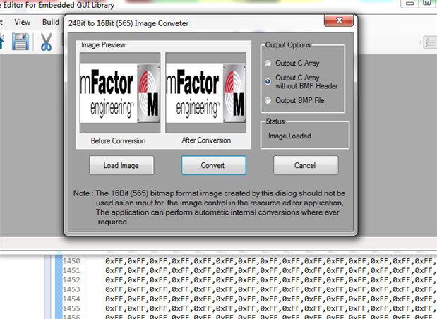

I downloaded a GUI (graphical user interface) editor from here;
STM32 embedded graphic object/touchscreen library
and tried to output the logo into a c hex array.
I then took the C hex array and replaced ImgMtkSplash320x240 with the one I created. I cleaned the project and re built it to find that when I launched it the old logo was still there that the previous developer had implemented.
Even deleting the entire c hex array doesn't affect the old logo. Its still there.
