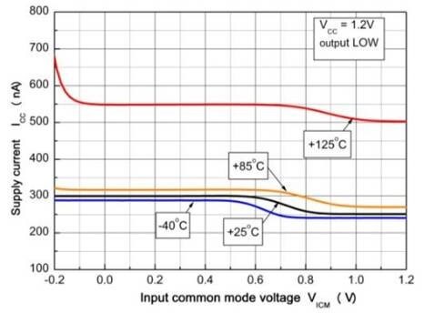

The TS881 is a single comparator featuring ultra-low supply current (220 nA typical with output high, VCC = 1.2 V, no load) with rail-to-rail input and Push pull output capability.
The performance characteristics of this comparator allow it to be used in a wide range of portable applications. It minimizes battery supply leakage, thus enhancing battery lifetime. Operating from 1.1 V to 5.5 V supply voltage, this comparator can be used over a wide temperature range (-40 to +125°C), keeping the current consumption in the nanopower range. The TS881 is available in an SC-70 surface mount package, allowing considerable space saving on the PCB.
Current consumption vs
Input voltage @ Vcc=1.2V
