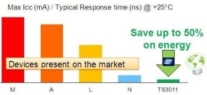

ST’s TS3011 single comparator achieves a propagation delay of 8ns while consuming only 470 µA of supply current at 5V, which is 50% lower than other solutions in the market. This unmatched energy efficiency allows ST customers to design products that use less power and have less impact on the environment.
